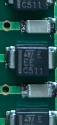

Pls help me identify this component.
Zahnelf
I'm looking for an alternative product to this diode.
I can't find any data sheets to the original product myself, so im hoping you can help me out.
Looks like SM6T18A TVS diode based on EE marking.
