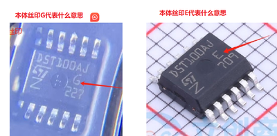

Model VND5T100AJTR-E, brand STM, body silkscreen: ‘G’ and ‘E’ mean what respectively?
WuZunMing
Model No. VND5T100AJTR-E, Brand No. STM, what do the silk-screened ‘G’ and ‘E’ on the material body mean? I didn't find the relevant description in the specification, please help me to answer, thank you!

Model No. VND5T100AJTR-E, Brand No. STM, what do the silk-screened "G" and "E" on the material body mean? I didn't find the relevant description in the specification, please help me to answer, thank you!
E and G stand for the respective ECO level, both are RoHS compliant and differ only in minor details. Details on RoHS can be found in the Material Declaration on the product website.
Hope that helps?
