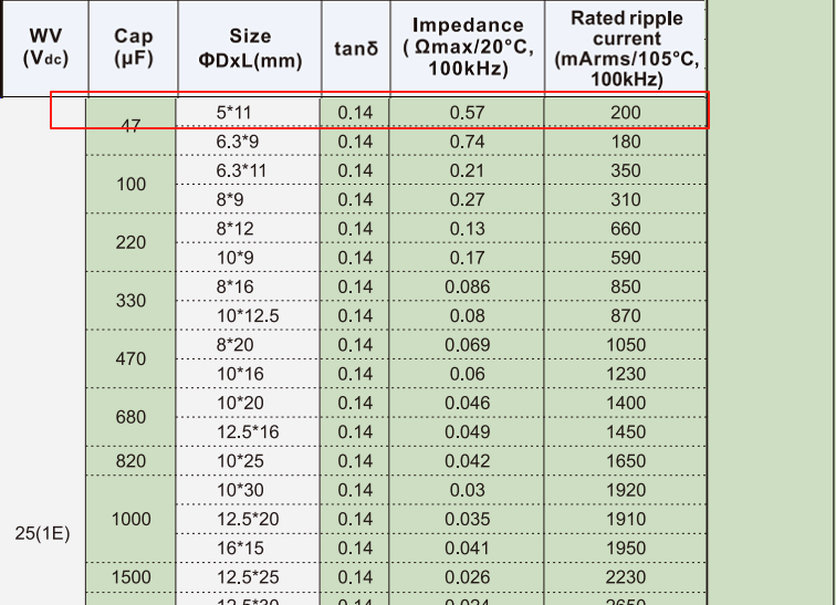

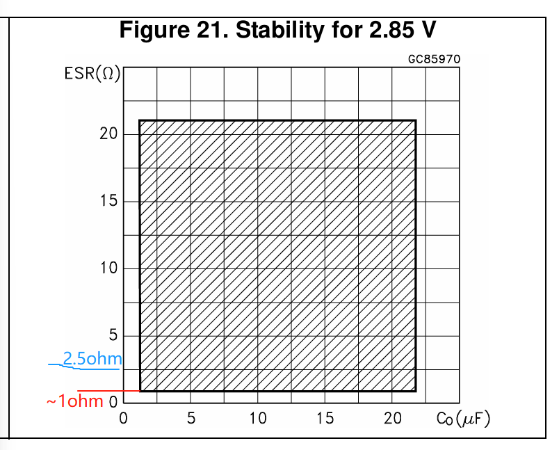

I plan to use the LD1086DT33TR LDO to output 3.3V with an input voltage of 5V. However, I am not aware of the requirements for the ESR (Equivalent Series Resistance) of the output filter capacitor for the LD1086DT33TR, and this parameter is not mentioned in the datasheet. I intend to use either the GRM31CZ71C226ME15L or the CC1206KKX7R6BB226 as the output filter capacitor, and I am considering using two such capacitors in parallel. I wonder if this configuration is appropriate.(Or a 25YXF47MFFC5X11)?
  1. The stability zone looks essentially the same for all voltages; with a minimum ESR of 1 ohm, you are on the safe side.
  2. On the one hand, the ESR should be as small as possible for a fast response to load changes, but for stable operation it should not fall below the minimum value mentioned under point 1 above.
  3. Electrolytic capacitors probably have a higher ESR anyway, so you don't need to worry about that. The frequency dependence mentioned above is more relevant for MLCCs.

For the LD1086, you will find some tips for stable operation in the data sheet in figures 20 (Stability for adjustable) and 21 (Stability for 2.85 V), from which a minimum ESR of approx. 500 mohms (ADJ) and 250 mohms (2.85 V) can be read. Although the regulator seems to operate on DC, the possible rate of change of the load must still be taken into account for the frequency, so that approximately 1kHz should be assumed depending on the application.

  1. I plan to use the LD1086 with a 3.3V output. Do I need to refer to the "Stability for 2.85 V" specification to select the electrolytic capacitor?
  2. To keep the LDO stable, does the ESR of the capacitor need to be between 1~20 ohms?

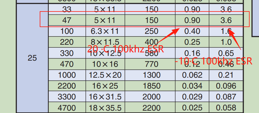

  3. At which frequency should we determine the ESR? 1kHz,100khz It seems that the electrolytic capacitor datasheet does not include a curve showing the relationship between ESR and frequency.?

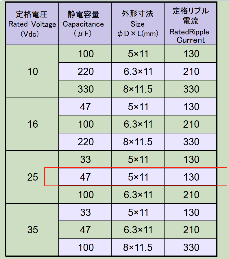

  4. Unfortunately, I couldn’t find the ESR parameter in the datasheets of the following electrolytic capacitors. Only high-frequency, low-impedance electrolytic capacitors provide ESR values corresponding to 100kHz. How should I proceed with the selection?

111.png1111 ERS1EM470D11OT.png222225YXF47MFFC5X11.png333325YXM47MEFR5X11 .png
  4. See 3
