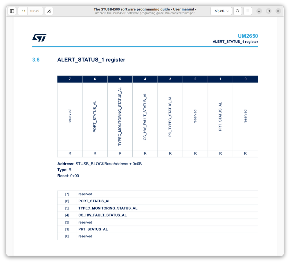

If I have a look to chapter 3.6:
0693W00000Y7b32QAB.pngThe fields are not documented. For example what are PORT_STATUS_AL and PRT_STATUS_AL?
You can also see that bit 2 is missing in the array and bit 3 is not consistent with the register drawing.

To summarize both (I assumed that the bits description is wrong and used the register drawing):
  • bit 0: reserved vs PHY_STATUS_AL
  • bit 1: PRT_STATUS_AL vs PRT_STATUS_AL
  • bit 2: Reserved vs Reserved
  • bit 3: PD_TYPEC_STATUS_AL vs PD_TYPEC_STATUS_AL
  • bit 4: CC_HW_FAULT_STATUS_AL vs HW_FAULT_STATUS_AL
  • bit 5: TYPEC_MONITORING_STATUS_AL vs MONITORING_STATUS_AL
  • bit 6 : PORT_STATUS_AL vs CC_DETECTION_STATUS_AL
  • bit 7: Reserved vs HARD_RESET_AL
In bold are "understandable" differences, in bold italic are inconsistancies....
At least CC_HW_FAULT_STATUS_1 and CC_HW_FAULT_STATUS_0 share the same kind of issue.

Benoit FORET
Hello Julien,
There is no additional User Manual unfortunately. But we are going to update UM2650 based on your feedback.
In the meantime, a few explanation:
  • “DataRW[0] is never used�?:
==> it is used indeed as Clear on read of PORT_STATUS_ALARM bit in ALERT_STATUS register.
Similar mechanism are used for clearing PRT_STATUS_AL.
Please consider STUSB4500 is a standalone / Autorun PD controller. The software layer is optional, and sample code has been shared to illustrate additional features and fasten application set-up with limited software skills. We do agree the code is not production level, but this is not the original intent. This is why the code is open, and not compiled.
If any specific feature you would like to implement, please detail, and we will advise.
