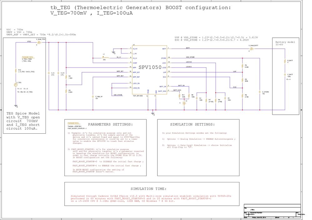

@luckysquad​ ,
I provide you a zip file containing the following:
  • SPV1050_ORCAD_project.zip :
    • containing both the .lib of the model and the .OLB for the PSpice symbol.
    • containing a README.docx (also reported at the bottom of this post)
  • 2 pdf with application schematics, TB_TEG_schematic.pdf, TB_TEG__MIN_Pin_schematic.pdf, simulated in the context of the OrCAD project in the .zip and related to the TEG source. You could use them as a starting point for your simulations.
Regards,
Marco
SPV1050 Macro-Model for Cadence OrCAD PSpice
The SPV1050 Macro-Model has been developed and validated by using the simulation platform Cadence OrCAD ORCAD PSPICE v16.6.
The standalone SPV1050 macro-model library (encrypted) is ./LIB/SPV1050_macromodel.lib
and its symbol library is ./LIB/SPV1050_macromodel.OLB .
This archive SPV1050_ORCAD_project.zip contains the sample OrCAD project SPV1050.opj and all its related files, to show the
SPV1050 macro-model usage in the following four application schematics testbenches:
            1) TB_PV: testbench BUCK-BOOST using a panel with Voc=9V e Isc=100u;
             2) TB_PV_with_SHADOW: testbench BUCK-BOOST using a panel with Voc=9V
                  and Isc=100u at startup and after a shadow that reduces the panel power to 30uW
                  with 150mV on MPP: in order to simulate this testbench the parameter Tsample has
                  been fictious reduced from 16s to 2s to allow a fast tracking of the fast shadow;
           3) TB_TEG: testbench BOOST using a TEG con V_TEG=700mV e I_TEG=100u;
           4) TB_TEG__MIN_Pin: testbench BOOST using a TEG with minimum power, with
                V_TEG=500mV e I_TEG=30u.
For the BOOST configuration, a parameter called FAST_BOOST_STARTUP had been defined and if it’s set to 1, it allows
the capacitor CSTORE charge through a constant current during the startup till 2.5V, in order to speed-up the startup behavior
by avoiding the slow charge pump activity.

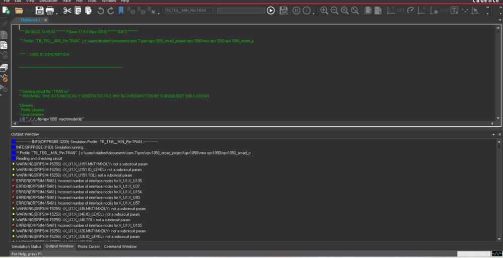

0693W00000Nqc2LQAR.jpgI already get the file and do simulation using PSpice OrCAD cadence. but when I try to run the file that you gave me, the error comes out. it said ( shown in picture). did you know how to solve this error? and I realize something that the .lib file was encrypted. is it because the file was encrypted so the error come out??

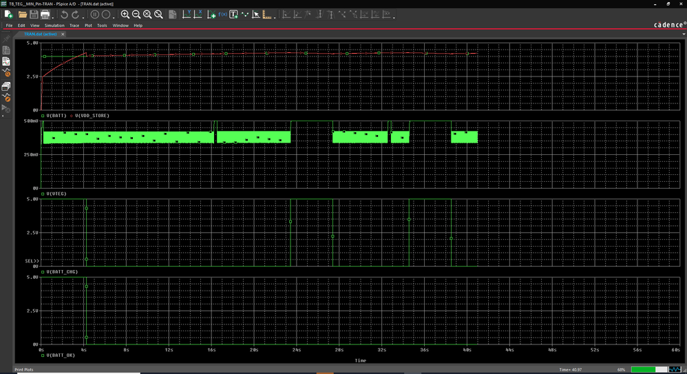

Marco FICHERA
@luckysquad​ ,

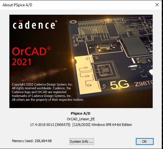

The sent SPV1050_ORCAD_project works successfully in ST side, probably you are is using an old and not patched or not full features Cadence OrCAD PSpice v17.4 platform:
below you find the ST obtained simulation results by running the user tried testbech TB_TEG_Min_Pin and the ST used OrCAD v17.4 platform ( it isn’t a demo version but a full licensed features) .
Cadence OrCAD environment exhibits some issues managing projects stored in long Windows path therefore try also to store and start the SPV1050_ORCAD_project from a shorter path folder , for example from c:\temp.
Regards
Marco
