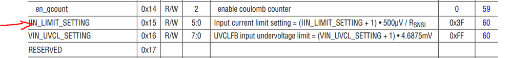

  2. Start the communication : ( for example to read data from register address (0x15) which is
HAL_I2C_Mem_Read(&hi2c1, DevAddress, 0x15,1, (uint8_t*)(&register_value), 1, 1000);
