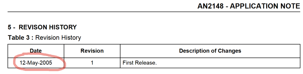

Please update information about STMPS2151 on https://www.st.com/en/switches-and-multiplexers/stmps2151.html#documentation
This is "AN2148 STOTG04 IN AUDIO CARKIT ENVIRONMENT" But inside pdf there is
0693W00000GZ8eXQAT.pngAlso there is no "STMPS2151" text inside AN2148. May be this application note isn't about STMPS2151?

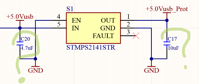

ALso I suggest add typical schematic on DS5410 Enhanced single channel power switches For example I don't know should I use capasitor on In and OUT pins?
Your questions only have the component group in common with the one originally asked, so it would be better to open a new topic for them.
But to briefly go into the mentioned capacitors: yes, a 100nF ceramic cap between IN and GND makes perfect sense. Depending on the requirements, additional capacitors at IN and OUT are also possible, as mentioned in the datasheet of the similar dual switch STMPS2242, section 7.1.
