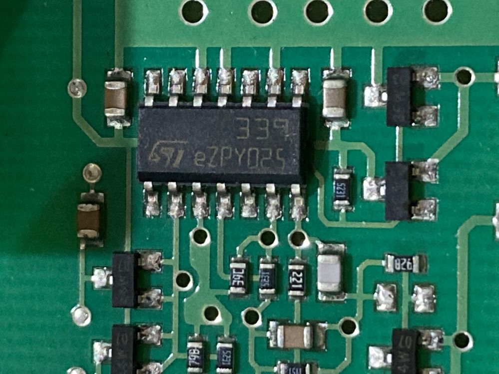

Can't find ST IC Soic-14 with : eZPY025, may be a PWM controler
AToml.1
Hay to everyone,
My name is Tony, live in Melbourne, Au.

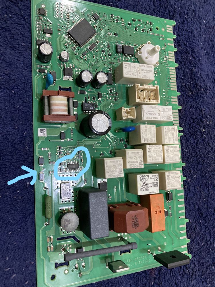

I am fixing electronic boards for house appliance and often use ST products.
This time I need to replace a IC from ST with writing : eZPY025, I think is a 100KHz PWM controler. Can't find anywhere Data sheat for it or source to bay.
Hopping someone on Forum can help, thanks Tony.

That seems to be a LM339 Komparator.

Attach clear picture of device in circuit.​
AToml.1
0693W00000AQ94JQAT.jpg0693W00000AQ946QAD.jpgHi Tesla, thanks for fast replay, hope the pics will help, regards Tony.
AToml.1
Thanks Uwe, I will download Data sheat and compare.
