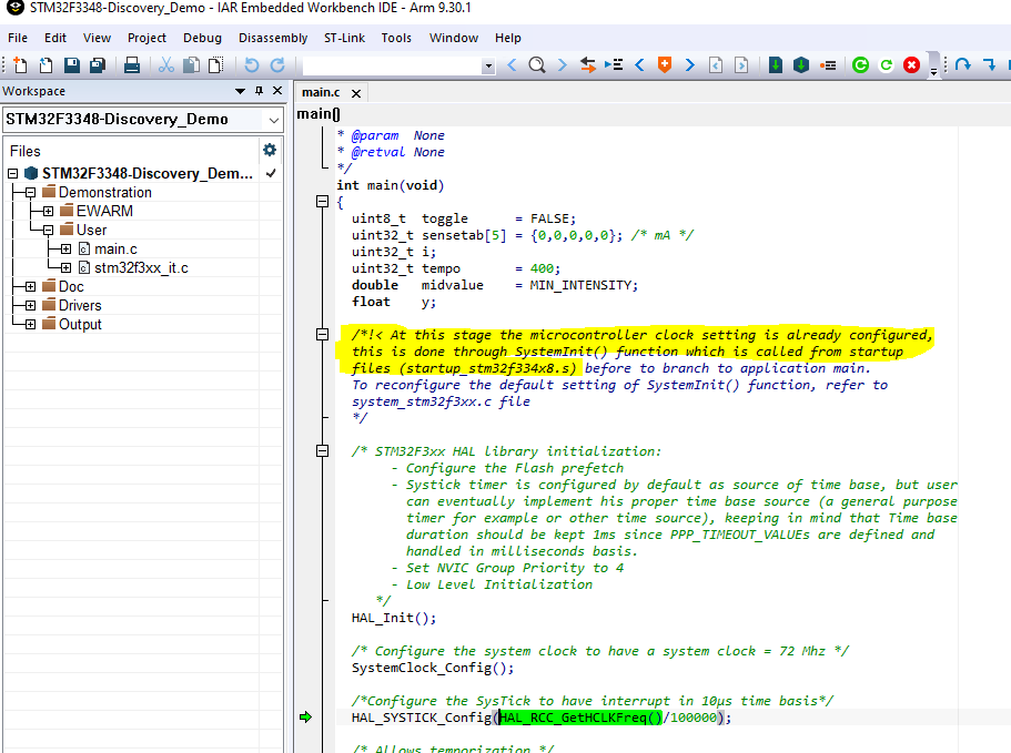

Yes, the example code seems to work with IAR, thank you very much for the suggestion! Now, there is something very interesting going on as it was mentioned in a comment some crucial processor clock settings are in an .s file, and that these are set up before even reaching the main() entry point (see highlighted text). Is for the STM32CubeIDE the .ioc0693W00000bhUoKQAU.png file equivalent to the .s file here, and could my failure to debug any code have originated in an incorrect .ioc setup? There were only some warnings, but none of the clock settings were red. I thought that the .ioc file is only creating a text substitution, updating the init function with the correct commands.I appreciate any explanation / link, as that seems to be the root cause of all my troubles with the CubeIDE.
The startup.s file typically contains the vector table, and enough assembler code to get the C Runtime working. In the CMSIS implementation you typically call SystemInit() to get the MCU and external memories functioning to the point where C statics and C++ constructors can be initialized, before calling main()
On IAR some of this is done via __iar_program_start
        THUMB
        PUBWEAK Reset_Handler
        SECTION .text:CODE:NOROOT:REORDER(2)
Reset_Handler
        LDR     R0, =SystemInit
        BLX     R0
        LDR     R0, =__iar_program_start
        BX      R0
SystemInit() typically lives in system_stm32f3xx.c or similar file. Often get the FPU started, clocks/PLLs, and points the Vector Table into SCB->VTOR register.
Clem1
Doesn't that type of information normally go into a .ld linker script, for example defining the entry point address and where certain memory sections sit? From a practical viewpoint, say that one does not have to write the .s file manually (which I sincerely hope!), is there a proven workflow to setup a EWARM STM32 project (HAL/CMSIS for DSP) from scratch for any STM processor on any board, such as STMCube -> GUI selection of processor, clocks and ports -> .s file -> compiler/linker settings in IAR?
The MCU runs code not linker scripts.
Th​e linker script tells the Linker how the memory is arranged so it can build a suitable image.
ST provides sample startup files for the major tools chains. The GNU/GCC one working for CubeIDE, Atollic, SW4STM32, etc.
There are project templates too. For IAR and KEIL​ should be able to clone or dupe those.
ST has Programing Manuals akin to the ARM TRM. Joseph Yiu has a series of books​ with a more user centric perspective.
