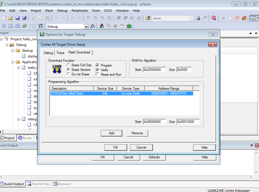

Now I'm trying to implement another Cortex M3 project  with MDK.
After compile done, I've got the following messages
After Build - User command &sharp1: C:\Keil_v5\\ARM\ARMCC\BIN\fromelf.exe C:\work\BP210\BP210\BP210\systems\cortex_m_mcu\testcodes\hello\hello.axf --vhx --8x1 --output hello.hex
'.\hello.axf' - 0 Error(s), 0 Warning(s).
Build Time Elapsed: 00:00:00
Load 'C:\\work\\BP210\\BP210\\BP210\\systems\\cortex_m_mcu\\testcodes\\hello\\hello.axf'
No Algorithm found for: 00000000H - 00000C17H
Erase skipped!
Error: Flash Download failed - 'Cortex-M3'
Flash Load finished at 16:45:37
What does 'No Algorithm found' mean?
what am I supposes to do to resolve this problem?
#mdk
Imen.D
Posted on October 19, 2017 at 10:25
Try to
add the stm32f flash  in 'Programming Algorithm':
Project >> Options for Target >> Utilities >> Settings, Then in the 'Flash Download' tab click [Add] to add your STM32 flash.
Kind Regards
Imen

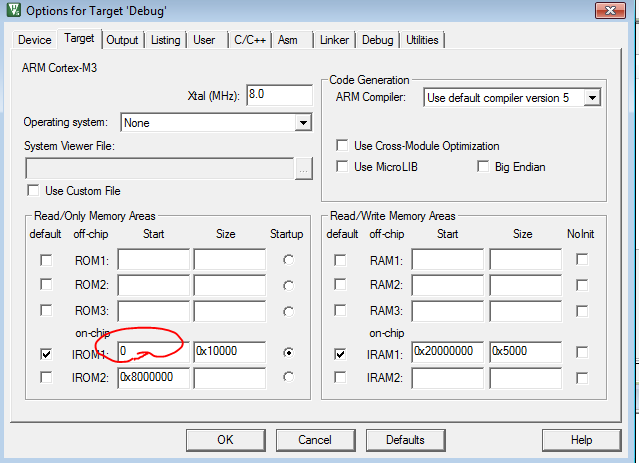

Posted on October 19, 2017 at 10:40
Thanks But I'm still having the problem.
*** Using Compiler 'V5.06 update 5 (build 528)', folder: 'C:\Keil_v5\ARM\ARMCC\Bin'
Build target 'Debug'
After Build - User command ♯ 1: C:\Keil_v5\\ARM\ARMCC\BIN\fromelf.exe C:\work\BP210\BP210\BP210\systems\cortex_m_mcu\testcodes\hello\hello.axf --vhx --8x1 --output hello.hex
''.\hello.axf'' - 0 Error(s), 0 Warning(s).
Load ''C:\\work\\BP210\\BP210\\BP210\\systems\\cortex_m_mcu\\testcodes\\hello\\hello.axf''
No Algorithm found for: 00000000H - 00000BCBH
Erase skipped!
Error: Flash Download failed - ''Cortex-M3''
Flash Load finished at 17:40:08
Posted on October 19, 2017 at 10:43
I found the problem,
Thanks
