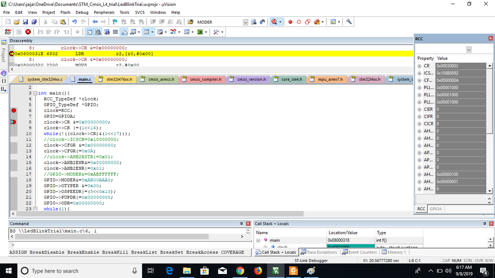

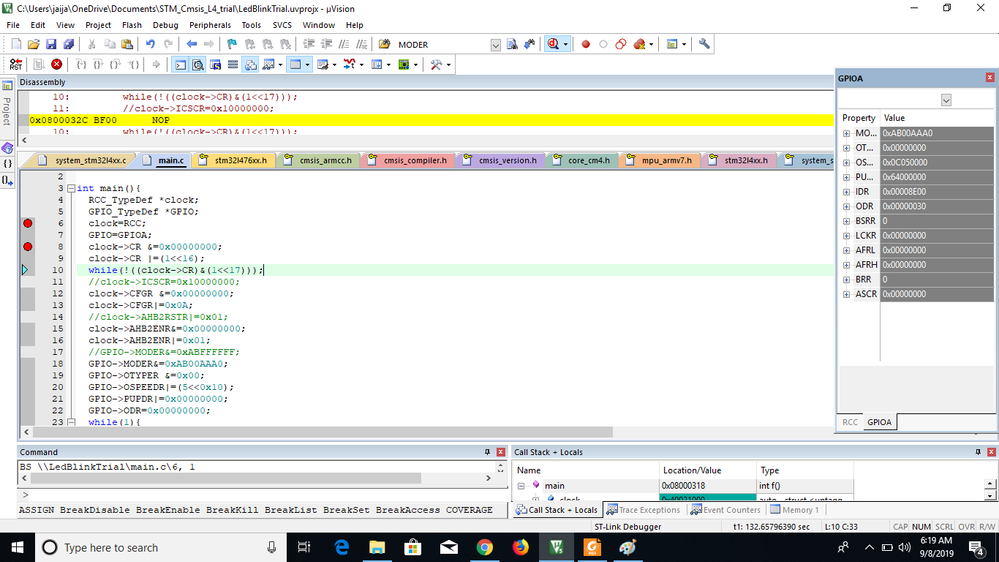

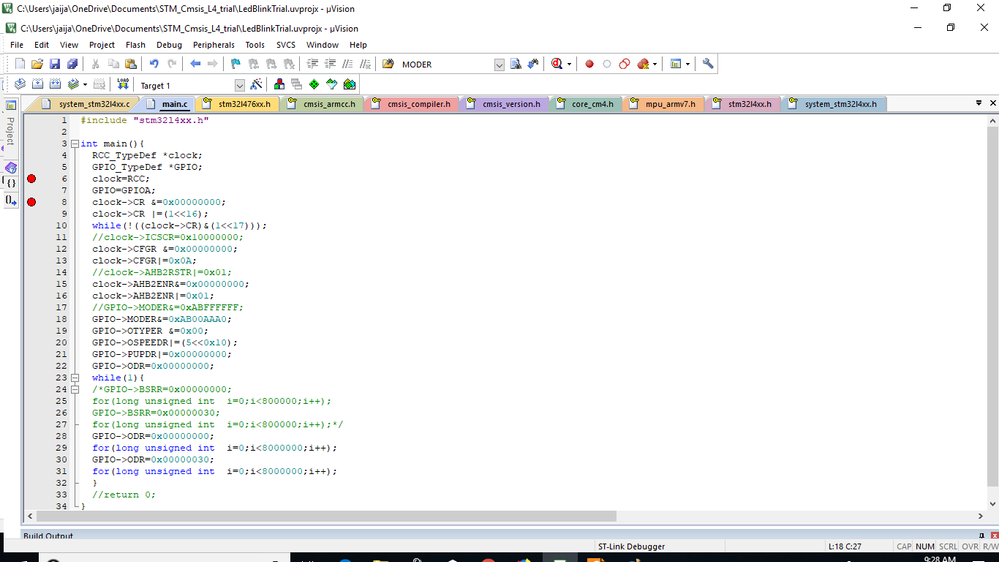

Unable to toggle the on board LED with this code,however the the PA5 bit of nucleo STM32L476RG toggling in debug window of Keil.

Thank you for posting this query.I have solved this problem .There was a mistake in MODER register in the code.
