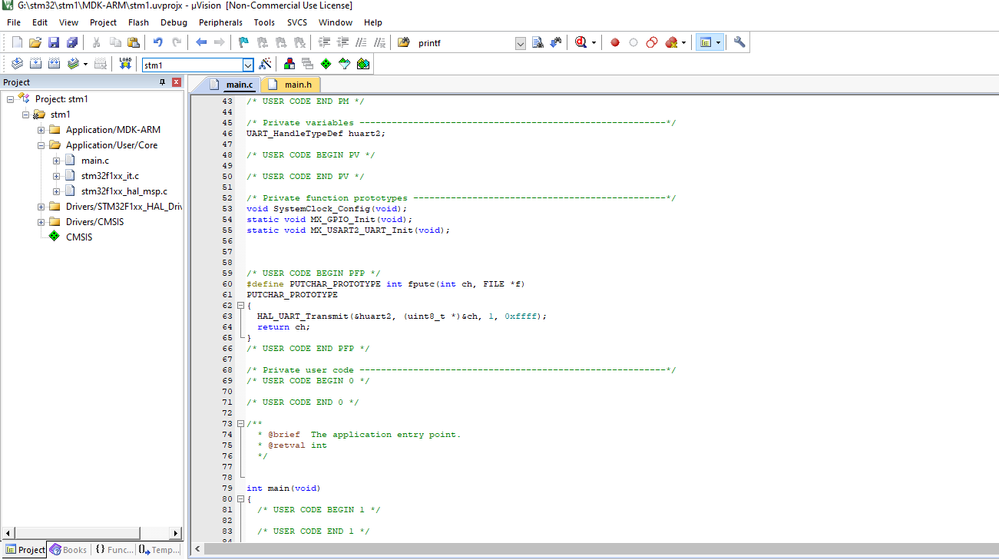

hi im using stm32f103c6t6 arm controller printf is not working i followed steps which provided a peace of code attached.

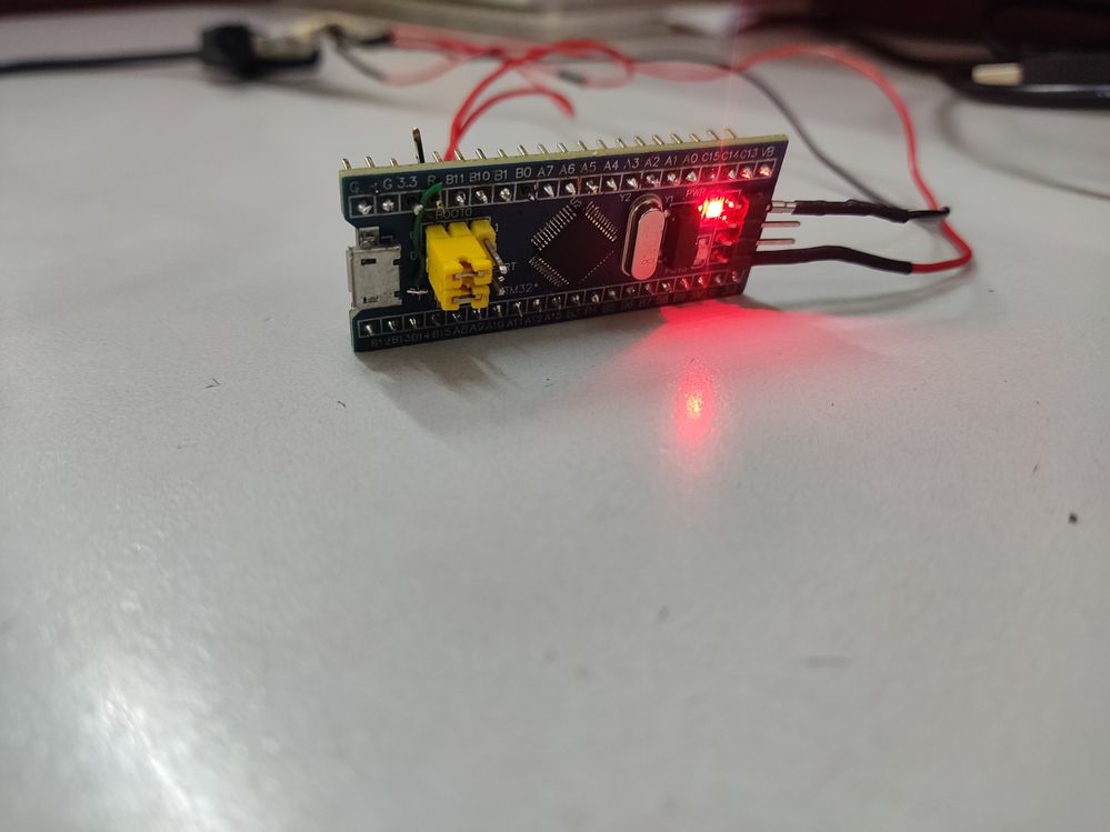

yes its working fine but i need to print it using printf if i put printf its not working.
for that im enabling led in EV board if i put printf the loop is not running.
@Community member​

https://community.st.com/s/article/how-to-redirect-the-printf-function-to-a-uart-for-debug-messages
This example i referred which is from stm community. not worked

#include <rt_misc.h>
#if 0 // enable for Keil 5.xx compilers
#pragma import(__use_no_semihosting_swi)
struct __FILE { int handle; /* Add whatever you need here */ };
FILE __stdout;
FILE __stdin;
#endif
Make sure "Use MicroLIB" is checked in Target window
Use #include <stdio.h>
and above fragment
Still doesn't work, going to need to use the debugger
‎2023-03-31 9:13 PM
hey @Community member​ its not working same problem if i put printf in while loop the loop not executing.i pasted my code down please resolve my problem.

‎2023-04-01 8:49 AM

‎2023-04-02 9:04 PM
the problem is same for this code too. i loaded your code see suddenly the loop is hanging and led not working i'm not getting why its not working. In other stm family that small code is working but here not working.

Perhaps try using the debugger?​
USART2 PA2 PA3 ?​
‎2023-04-02 9:27 PM
yea some problem with usart2 its not working. but for usart one also unable to print but its working fine in debug mode.
