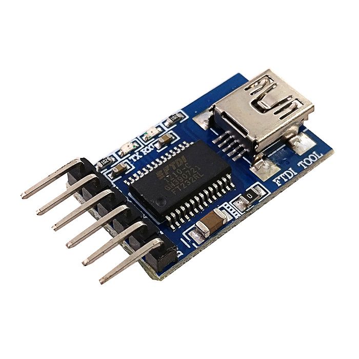

Are you trying to program it directly using the USB connector on the PCB ? If so, you'll continually have this problem so the simplest solution is to get a $1 CH340 USB-serial adapter and change to programming over serial. It's not possible to overwrite this part of the bootloader so you'll be safe.
Ok that's similar to the CH340 one and fine. Your other settings are the same as I use for my Blue Pills, apart from I use a PC so can't help you with MAC drivers.
Do you have another Blue Pill you can check it with ? Otherwise I'd look at the drivers and/or the wiring to the Blue Pill.
And I assume you have moved the boot0 connector to the 1 position and just left it there for now ?
I have soldered the 3.3V connection underneath the board
Is there any videos that you could send that tells how to set it up with Arduino IDE? And what drivers is this you're talking about?
