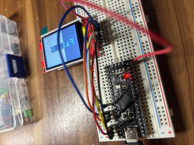

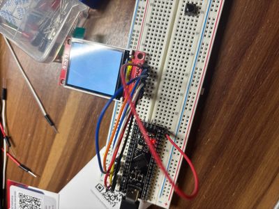

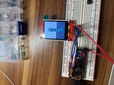

  • Hello, I could use your help. I wanted to start a small project where an ST7735 display with an STM32F401CCU6 simply writes text. For some reason, I started with the wrong library, namely Adafruit_ILI9341, which resulted in the first photo. When I finally realized that I was using the wrong library, I switched to Adafruit_ST7735, but here I have the problem that it doesn’t get through the initialization (that’s my assumption). I’ve already tried the different initR variants. I’m happy about any help!

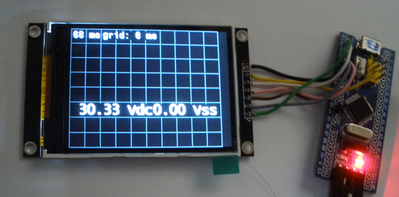

if you want , can try my lib... --- no. I just see: your on Arduino... i use the STM32CubeIDE , different.

thanks for the help, I already tried red, green and blue tab. I also tried to use the CubeID but to be honest it was a bit overwhelming. But i would like to give it a second try with your library because i couldn't find an F4 library without any mistakes in it.
ok, but its used with/in CubeIDE , so...try with this.
You have to edit here the pin + spi numbers, to fit your connections:
