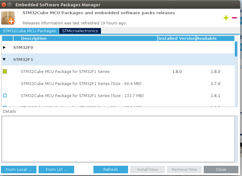

I have Installed Atollic IDE and STM32CubeMX and also installed Embedded Software package for STM32F in CubeMx, reference Image attached below

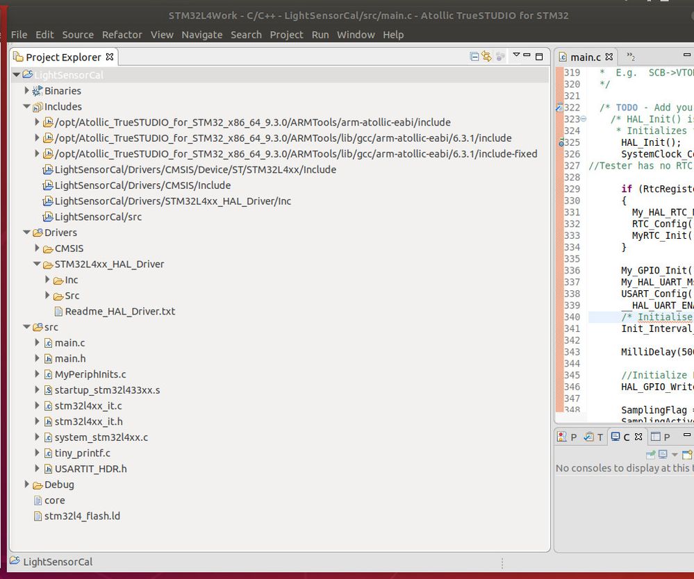

I have Atollic 9.3.0 on Ubuntu 18.04. I use the HAL library, but no Cube, and it works well.
I have a copy of the library in each project. See screen print showing includes and source for an example.

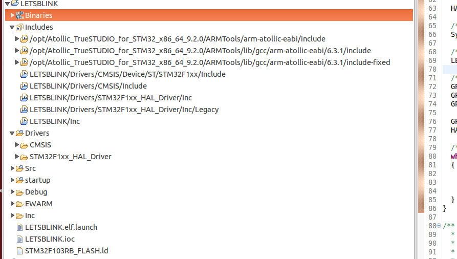

I have checked in my code and i am able to see HAL driver library in the code (attached the Image of the same) but still i am getting the same error, Does this mean i have to download any other library compatible for by board and link it ?

How can i solve the path error issues?

However now i am not getting path error Path Error is resolved,

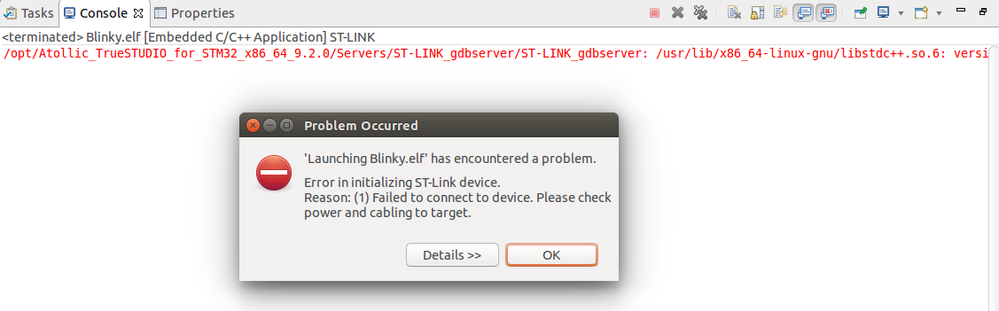

However I am Facing issues while debugging the code i have attached the screen shot also,
Understanding the Error and Suggestion for Error i tried changing the Power cable with two new Cable but i am still facing the same issues.
Whereas If that Cable used for any other purpose its working fine.
So Please help me to solve the Issue

My issue got solved when i upgraded my Linux to Ubuntu 16.04
