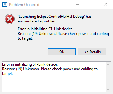

There seems to be a problem when trying to program an external flash chip via TrueStudio.
I have created an external loader to program a QSPI chip that is connected to an STM32F469II.
My loader is working via the "STM32 ST-LINK Utility", "STM32CubeProgrammer" and STM32_Programmer_CLI.
When I try to use the loader via TrueStudio I run into the problem that the external memory is not programmed.

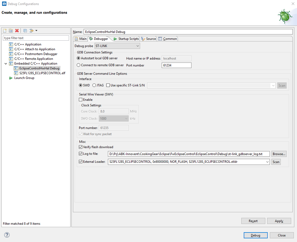

I have selected the external loader via the property screen of the debug configuration.
When I try to program the device when the external loader is set I get the following error.
the log message that I get when programming.

Failed to initialize external memory!
Error in initializing ST-LINK device.
Reason: Unknown. Please check power and cabling to target.

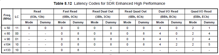

I can use Read Quad Out, but what I could verify is that with Read Quad Out command I can set only up to 13MHz, if I increase more than this I always get the first bit from each nible setted, like this:
If I should read 0x01 (00000001b) I read 0x89 (10001001b), so always this bit is set with higher frequencies.
The Fast Read command works in 100MHz properly, so I don't think it could be a layout problem.
I tried to change Latency Code bits and dummy cycles according to datasheet, but without success.
The strange thing is for Freq up to 50MHz the LC bits and dummy cycles don't change, so it should work at least up to 50MHz, but I could reach only 13 MHZ.

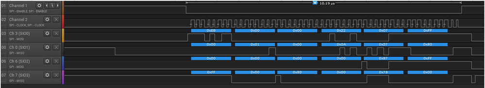

Please verify the info below:
This is written in 0x00000000 address in external flash (I read with fast read command that is working properly):
Below is what I've read with this parameters:
  /* Initialize the read command */
  s_command.InstructionMode   = QSPI_INSTRUCTION_1_LINE;
  s_command.Instruction       = QUAD_INOUT_FAST_READ_CMD; /*0xEB */
  s_command.AddressMode       = QSPI_ADDRESS_4_LINES;
  s_command.AddressSize       = QSPI_ADDRESS_24_BITS;
  s_command.Address           = ReadAddr;
  s_command.AlternateByteMode = QSPI_ALTERNATE_BYTES_4_LINES;
  s_command.AlternateBytesSize = QSPI_ALTERNATE_BYTES_8_BITS;

But the physical signals don't represent this values, for example the first bit set in all data bytes doesn't appear in the signals, only in the code. Could it be a driver problem?
Regards

Well now I could get worked with 100MHz, but with different values than datasheet shows...
I needed to set LC = 11 | Mode = 2 | Dummy cycles = 1
Unfortunately according to datasheet's table above the values are others, but now works..
I can't believe that datasheet is wrong, but with different values it works..
