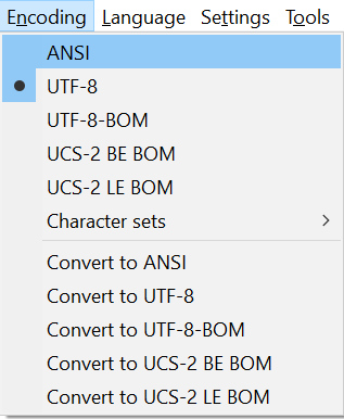

Hello @hroze.1​ ,
This seems like an encoding issue. Converting the file encoding might help you. Funnily enough, and because the file fits within Latin-1, you would be able to do that using Notepad++ by selecting the ANSI encoding and then saving the file:
Hope this helps.

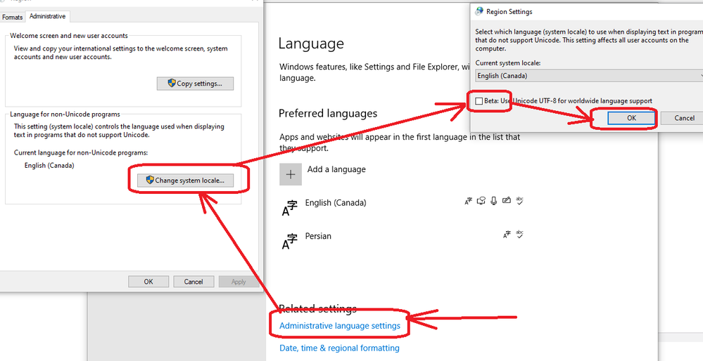

hroze.1
I have the same problem
An old computer works without problems A new computer has the problem
I would appreciate if you could share with me how you solved the problem
Mhass.21
I had the same problem, the problem is not related to Atollic itself, we need to diable utf8 for worlwide language in Windows
You are a genius. Thanks.
