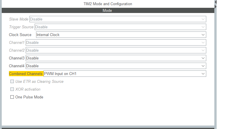

I use STM32F103c6 timer1 for pwm input . after right config in cubemx, and in simulink enable timer1 ch1 interrupt. Then auto code gen, but code in Keil the ch1 interrupt not enable, its callback not registered, the timer also not started. Want to know how to use timer1 pwm input in simulink, look forward to reply! Already Confused for one week ...

Hi, @PYong.2​ did you enabled the IRQs for TIM1 under NVIC in CubeMX?
yes, already enabled the IRQs for TIM1. For no solution,I choose to ​add start code to fix it. Thx!
hendrikk
And did you try a Cube configuration like this?
