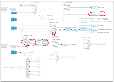

So, after almost half a year of arduous blood, sweat and tears I have managed to scrape together "something that works". It consists of a custom schematic and PCB powered by an STM32F042C6T6 and an Si4705 radio tuner (from Skylabs).

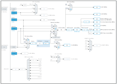

The STM32 uses the internal clock circuitry that is configured as depicted here. The CRS sync source is not shown here, but it is set to USB, so that the chip runs completely without any external crystals. The USB 2.0 is full-speed since the STM32 is only full-speed:
The Si4705 currently uses a precise, external 32,768 kHz crystal oscillator (SG-3030CM from Seiko) that only requires a by-pass capacitor. This crystal oscillator is not connected to the STM32 in any way.
The tuner chip has a prescaler and precise REFCLK adjustment so it can, if required, support a frequency range from 31130 Hz up to 140,89 MHz. Currently these settings are in their default values due to the crystal oscillator.

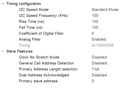

The STM32 commands the Si4705 via I2C, without DMA, and this communication works just fine. The relevant settings are shown below:

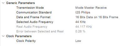

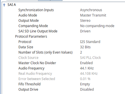

The STM32 also uses I2S and DMA to transfer data, and its settings are as shown here:
There are also several other settings that are related, and which can all be adjusted:
  • The Si4705 has a programmable sampling rate and bit resolution for I2S, and they are currently set to 44117 Hz (as per "Real Audio Frequency" from the STM32's I2S) and 16 bits (per channel)

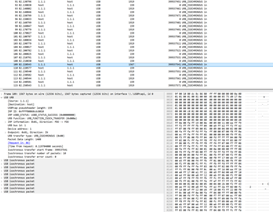

If I look at the Wireshark output I see an almost-clear recurring phenomenon: the device first sends approximately 22 frames with 1760 packet data length (10 microframes), then several frames with 1056, 880 or 1584 data lengths, before resuming with 1760 ones. Even these "shorter" packets claim to have 10 microframes in then. This repeats around every 22-24 frames but sometimes there's up to 30 "clean" frames before the shorter ones occur again.
This looks like a a bus saturation issue to me, with the host side unable to keep up. What kind of things I could do in order to try solving this? I know I am not far off from the result.

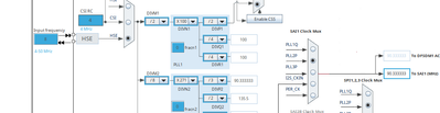

After some creative tinkering with the clock settings shown below
I managed to obtain an exact 48 kHz "real audio frequency" for the I2S. This has reduced stuttering quite a bit but I still hear occasional blips here and there.
I believe the only way to get even cleaner sound is to go lower-level and ditch HAL. I am aware that the "real audio frequency" might not be exactly what I get, and this may contribute to the overall scheme of things but I am running low on flash & RAM when using HAL like this so I'd need to do it anyway.

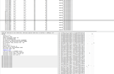

Initially I had the DMA buffer sized so that it was able to hold 2 ms worth of audio data (352 bytes), and then at HT and TC interrupts I would send the first half, and then the second half. The USB Audio endpoint wMaxPacketSize was set accordingly to 176 bytes, and a bInterval value of 0x01.
I then made an adjustment so that the DMA buffer is now 4 ms long (705 bytes) and at each interrupt I again transfer half. The USB Audio endpoint wMaxPacketSize was sized up accordingly to 352 bytes and bInterval raised to 0x02.
This reduced the stutter to almost imperceptible, as shown in the attached to samples.
In Wireshark, the packet is now staying near-constant 1760, with an occasional blip down to 1408 (which is then audible as a stutter). I must be getting close. If only I just could understand better what the system is doing as a whole...

I have set the tuner to 48k / 16b stereo but this did not fully resolve the issue. The approach is not optimal either as the "real audio frequency" in STM32CubeIDE is now 48387 Hz, and the tuner chip has a max value of 48000.
When I look at Wireshark now things have now turned around, and I mainly get isochronous packets with data length of 1920. This seems correct as (48000 * 2 * 2) / 1000 yields 192, and the USB driver on the host computer uses 10 ms buffers.
Occasionally, however, I see a solitary packet with data length of 2304. I interpret this so that the device is now sending too much data compared to what the host is expecting. This extra size is also audible as a small blip in the audio stream.

483xx is too much away from 48000,
Try to get a better clock tree setting.
Maybe you have to use a HSE crystal, 12.288 MHz, typical for 48k.
Or a more complex CPU with more adjustment in the clock tree.

Not even a more complex PLL here, see my setting on H743 for 44.1kHz generation from 8M HSE :
giving:   very close to 44k1
also 48k can be quite good:
But still you have to do some re-sync to the PC "48kHz" USB clock.
Because the crystal in PC and any crystal you use here, will drift - about 0.001% typical, but NOT zero.
So it never can work "perfect", except you can adjust the sample rate by a PLL (stepless ! ) or use a dedidacted chip , that can do it or use other USB mode (UAC2 might work, at hi-speed mode).

ankes
