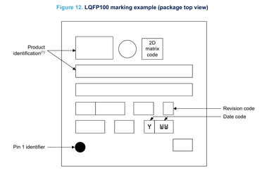

It's probably genuine. If you're concerned about getting genuine parts, stay with an authorized reseller. There isn't a parts shortage, these are in stock and available.
Markings change because manufacturing plants change and maintaining 100% consistent markings over decades is not a priority.
These chips were made 3.5 years apart from the date code.
