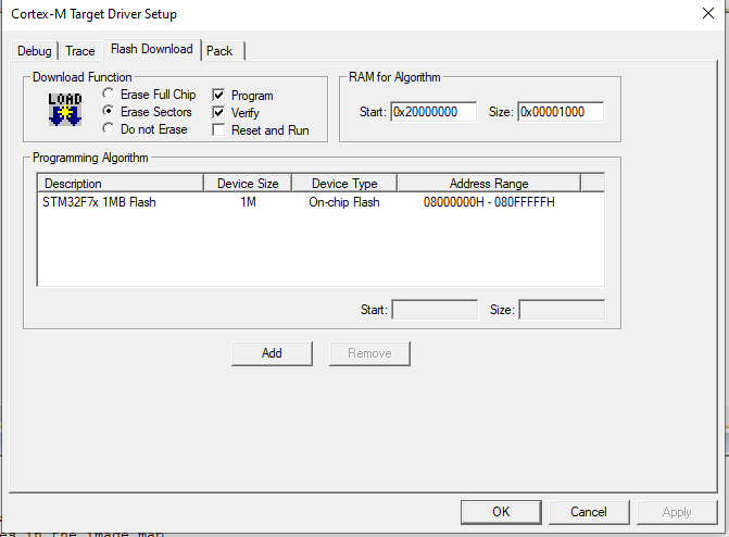

how i can create file .flm for w25q128 and set the setting in keil
‎2021-05-21 7:43 AM
I have tried a lot in creating a FLM file as well as how to configure the necessary settings in the Keil program. I am using w25q128 serial memory with quadspi protocol with stm32f746igt processor
Use this method because the processor is low on memory
#quadspi #w25q128

‎2021-05-21 7:47 AM
Do you have your own BSP code which works successfully with the W25Q128 in your system? That supports, read, write, erase, etc?
How well tested is that? Can you write a .BIN or .HEX from the UART to the QSPI Flash successfully? I would generally get all that working properly before trying to port it into a .FLM file.

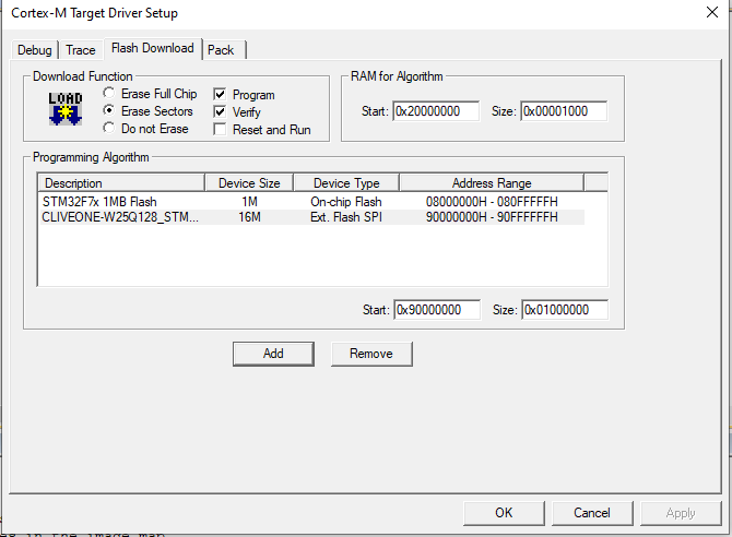

Unfortunately it did not work ever. Since Keil cannot see the file that you sent me to try it. Can I have the basic program that generates the memory code?

I tried to generate the keil program code it sees but it does not work Are the settings correct
‎2021-05-22 4:09 PM
Updated file, should be recognized now
‎2021-05-22 4:49 PM
#ifdef USE_W25Q128
KeepInCompilation struct FlashDevice const FlashDevice = {
FLASH_DRV_VERS, // Driver Version, do not modify!
"CLIVEONE-W25Q128_STM32F7XX-PB2-PB6-PF8-PF9-PF7-PF6", // Device Name

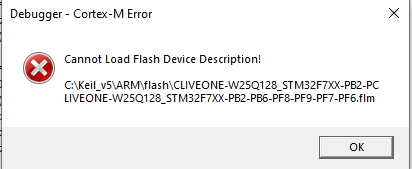

‎2021-05-23 4:25 AM
After adding the file .flm to the program and pressing OK, it will disappear from the list automatically
after
‎2021-05-23 5:45 AM
‎2021-05-23 6:06 AM
I'll set up a Nucleo and test later.
Try renaming to TEST.FLM
Change the RAM allocation to 0x4000
5.33 Didn't appear to be losing the the algorithm
