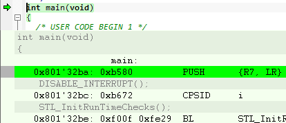

.5. also modify '#define VECT_TAB_OFFSET ' to 0x4000 in system_stm32f4xx.c

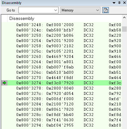

and when i run debug mode, it never stop at main(void) of app.
i also saw a message in Debug log window:
Thu Sep 09, 2021 19:11:58: Target reset
Thu Sep 09, 2021 19:11:59: DMAC: HCLK and FCLK will not be disabled in SLEEP/STOP/STANDBY modes.
did i miss some setting or need to modify source code?

When i run debug mode, and then click break, it stops at the address of bootloader part.(different addr. if i click run and break again)
what i expect is stop at main() off add as below figure(example from internet)
