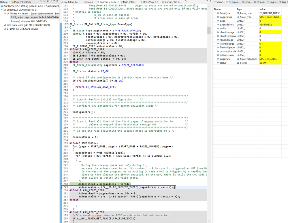

Can I run EEPROM_Emulation on the STM32L552CCT6?
tsato.2
X-CUBE-EEPROM v5.0.0 includes a sample for NUCLEO-STM32L552ZE-Q.
I am trying to use this sample for STM32552CCT6 to run EEPROM Emulation, but the EE_Init() execution results in an error.
To begin with, is it possible to operate EEPROM_Emulation with STM32L552CCT6?
tsato.2
Thank you for your reply.
The error was due to accessing an impossible address. Resolved by resetting the user-defined start address to the correct range.

tsato.2
thank you for your reply.
A Fault occurs when line 249 in EE_Init() is executed.0693W00000aHjqAQAS.png
Imen.D
Hi @tsato.2,
I try the example and it is working as expected.
Try these steps:
  • erasing the chip
  • increasing the stack size.
Imen
Thanks
Imen
tsato.2
