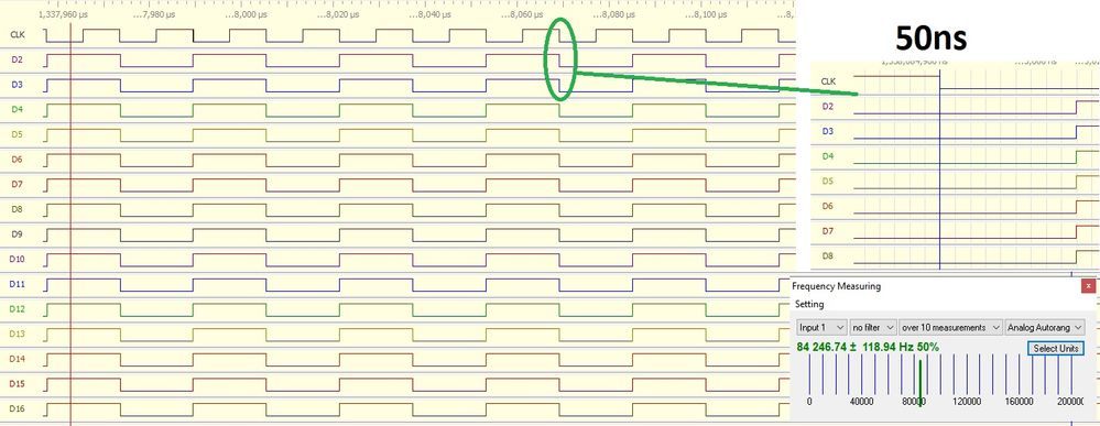

I working on parallel synchronous transmission. I am using LPTIM2 as clock (PWM) and GPIOE as data bus. It is working with BDMA but here is 50ns offset between Clock and data no matter what frequency I setup. Please see pictures below 84kHz and 8MHz.  So I would like to eliminate 50ns offset between clock and data.
I trying to make synchronisation at falling edge of CLK. And my goal is reach 16MHz.

Is this a timer-triggered DMA from memory to GPIO?
Surely, there's some propagation/resynchronization time from timer to DMAMUX, within DMAMUX, from DMAMUX to BDMA; then BDMA performs arbitrration, loads the value from the source memory and finally outputs to the GPIO, again all these processes take some time to accomplish.
You can compensate somewhat by triggering the BDMA from a different channel of the timer, slightly skewed to the one which outputs the "clock".
Note, that in a real program, not only a fixed delay is imposed, but due to potential conflicts within BDMA and on the source/destination buses of the DMA, this time might be increased at certain moments, resulting in jitter.

Yes a timer-triggered BDMA from memory SRAM4 to GPIO
Sure I understand that all these operation take some time, however the example AN4666 with STM32F4 and STM32L4 work without resynchronization.
waclawek.jan
And what is chapter 1.2.2 Data and clock alignment consideration talking about, then?
