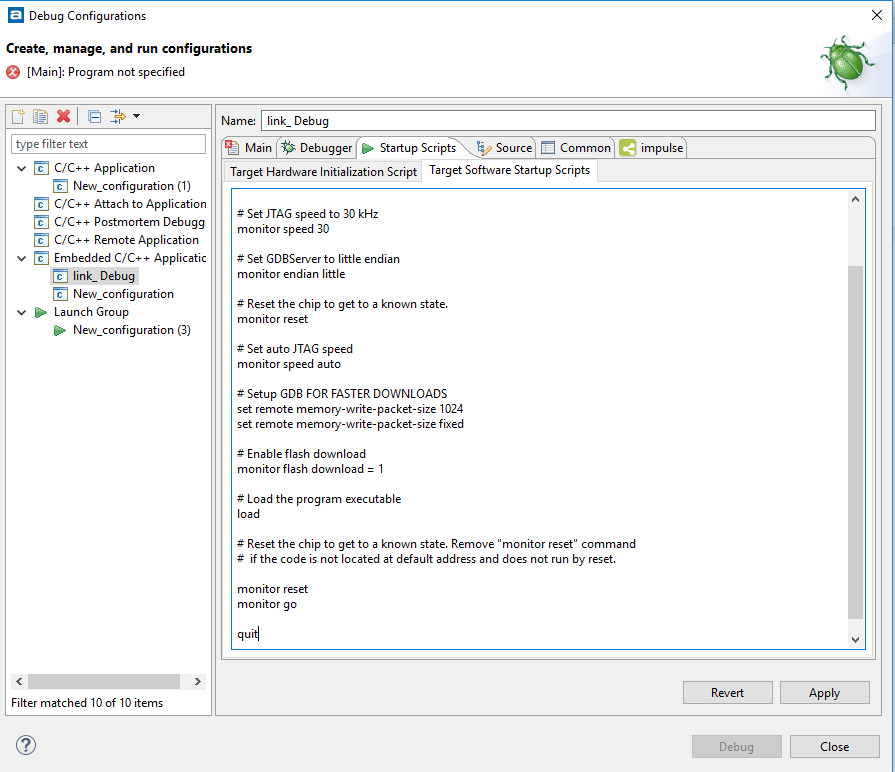

Hello, I'm still trying to load flash of STM32 without Debug through Atollic Truestudio.
Is anyone here, who solved this problem or help me?

Would a post-build step to create a HEX file (or similar format) do ?
You can then use the tools of your debug pod to flash it.
Using J-Link, I use a free JFlasher tool automatically installed with the drivers.
The ST-Link utility supposedly serves the same purpose.

‎2018-05-29 10:52 PM
I solved a problem. At first I created new embedded debug configuration, then I edited Startup script.
Behind ''load'' command I deleted all default commands and I added this commands :
monitor resetmonitor goquitThis configuration you can call RUN.
Run without debug is working now.
