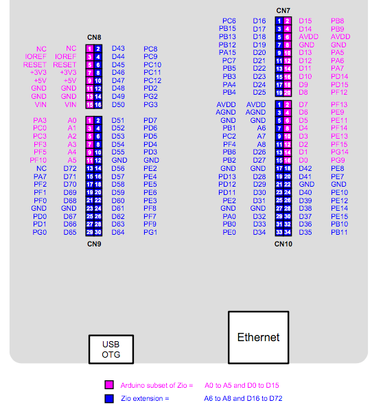

Here is ST-Zio and its Arduino subset, on Nucleo F767ZI, F746ZG, F429ZI, F207ZG, H743ZI:

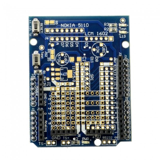

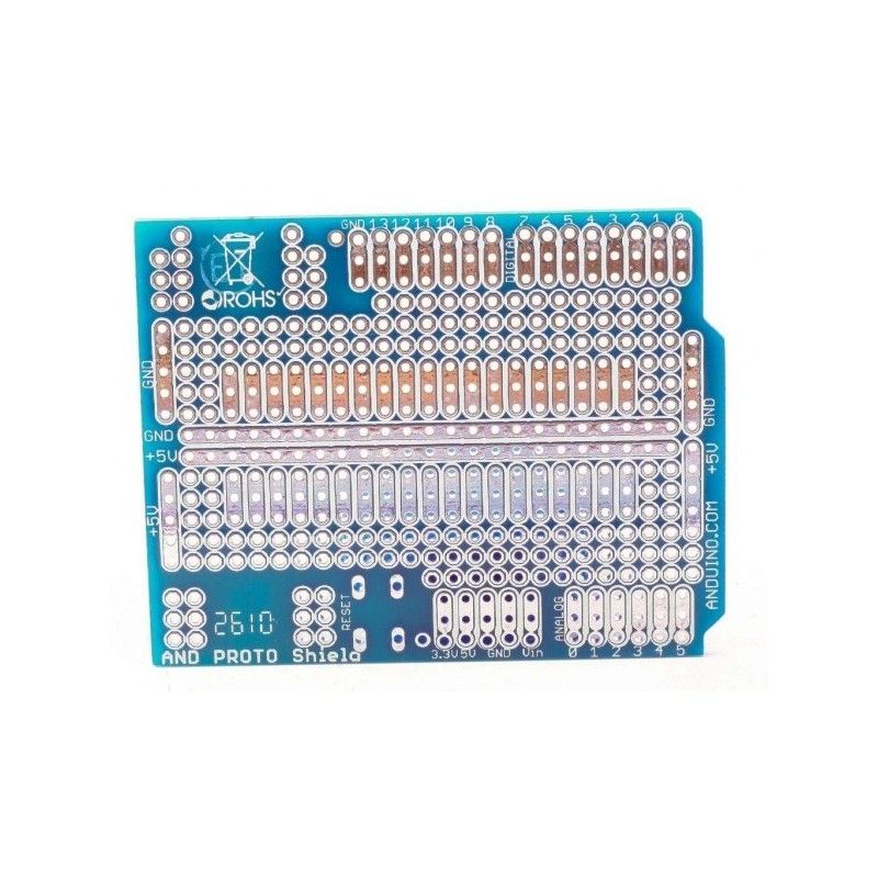

I looked for interesting 5V and GND arrangements. IMO much can be invented in this, however it requires thinking time spent on pure abstraction and future-only considerations ? ''what can be useful?''. So it disappointed me as somewhat expected: except for the nice Adafruit-like protoshields (using this one, but with headers and stack-plugs included) with two long rails 5V, GND, I've found only two more models:
https://core-electronics.com.au/protoshield-mini-breadboard-for-arduino.html
It is very specific, has Nokia pins, SPI pins, I actually don't know what this does mean, I guess it's that some pins are typically used for e.g. SPI, and they arranged them in one place, which is a courageous decision I think. So looks like they have made their thinking time on this.
http://rlx.sk/en/various-boards/684-arduino-proto-shield-and-tech.html
It's similar to the Adafruit-like one, but has longer 5V, GND rails, which might be useful. There is no SOIC place like on Af-like one. Rather nice trick at left and right ? because they don't include headers and stacking-slots, they have 3-pin leads there, which is interesting decision I think.

However, I can tell that maybe you could make a shield for ST-Zio subset different from the Arduino subset. So that you could still connect Arduino shield ? two shields in total. You would have to use bottom pins of St-Zio. I think Arduino-support is great and you should use it if you want to e.g. sell your thing, but maybe you are also interested in connecting two shields at once.
