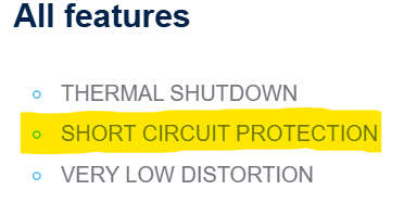

Where did you get that 'news' from?
If ST really did remove the short circuit protection, they're not telling us:
TDA7294 | Product - STMicroelectronics
Also, actually removing the SSP would most likely require a -costly- change to the chip design. This is a very, very mature part, so why would they do so?

Peter BENSCH
STMicroelectronics has not changed or removed anything from the TDA7294. However, I cannot comment on any possible changes made by counterfeiters, which can be found via dubious dealers on the internet.
