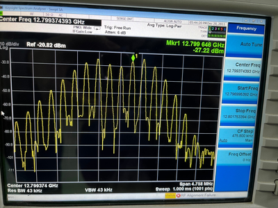

I config STuW81300 with this parameters:
STUW81300_WriteData (ST9_REG, 0x48000000);
STUW81300_WriteData (ST0_REG, 0x02600040);   // N = 64
STUW81300_WriteData (ST8_REG, 0x40080003);
STUW81300_WriteData (ST7_REG, 0x38102004);
STUW81300_WriteData (ST6_REG, 0x30001000);
STUW81300_WriteData (ST5_REG, 0x28000000);
STUW81300_WriteData (ST4_REG, 0x20039315);
STUW81300_WriteData (ST3_REG, 0x1C008002);
STUW81300_WriteData (ST2_REG, 0x14000001);
STUW81300_WriteData (ST1_REG, 0x0D400000);
and Read register:
00> Product codes STUW81300T and STUW81300TR
00> ST9 Register: 0x0
00> ST8 Register: 0x80003
00> ST7 Register: 0x102004
00> ST6 Register: 0x1000
00> ST5 Register: 0x0
00> ST4 Register: 0x39315
00> ST3 Register: 0x4008002
00> ST2 Register: 0x4000001
00> ST1 Register: 0x5400000
00> ST0 Register: 0x7E00040
00> ST10 Register: 0x3E0D0
The signal I measured is lower than −20 dBm. This is a screenshot from the spectrum analyzer
please support me fix this problem.
Thank you very much

If your question is still relevant despite the age:
There are indications that the STuW81300 is not actually configured as intended, which can explain an output level below −20dBm.
The upper bits are clearly not what you wrote. Examples:
  • ST3: written 0x1C008002, read 0x04008002
  • ST2: written 0x14000001, read 0x04000001
  • ST1: written 0x0D400000, read 0x05400000
  • ST0: written 0x02600040, read 0x07E00040
This strongly suggests:
  • the SPI frame (bit count, bit order, or timing of LE vs SCK) is not exactly as per datasheet, or
  • the address / CO bit is shifted.
If the registers in the chip do not contain what you think, you can easily end up with:
  • RF outputs powered down,
  • wrong PLL/divider configuration,
  • or partially powered-down blocks.
I'd recommend to:
  1. Fix SPI first
    • Confirm 32‑bit frames, correct CO & address bits.
    • Write a simple pattern, read back, confirm exact match.
  2. Use the datasheet example configuration
    • Program ST9, ST0, ST8…ST1, ST0 exactly as in section 7.18 of the data sheet
    • Read back ST0…ST8 and verify exact matching values (no bit shifts)
  3. Check lock and LDO status (ST10, LOCK_DET = 1, REG_*_*)
  4. Check PD pins and RF enable (PDRF1, PDRF2)
  5. Verify RF measurement (RFx_OUTP with proper termination at the unused differential pin, take cable losses into account)
