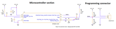

Welcome @DC_14, to the community!
With your assignment of SWIM, VCC and GND, you can debug and program, but only with ST-LINK/V2, ST-LINK/V2-1 and ST-LINK/V2-ISOL, not with ST-LINK V3.
Please note: there are many illegal clones of ST-LINK/2, for which functionality cannot be guaranteed (see, for example, the discussion about clones, even if it initially concerns the target platform STM32).
Does it answer your questions?
Regards
/Peter
