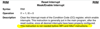

Thank you for the review. I'm curious what you mean by global interrupts being enabled in "but one thing to check is whether global interrupts are actually enabled"?
Sorry @jimmyande0 now I see what you mean. I did not include it in the code sample, but there is a wfi instruction further down. That will enable global interrupts (RIM instruction not needed with WFI).
WFI only makes the CPU wait; it does not enable global interrupts. So for TIM4 to wake the MCU and run the ISR, you still need:
  • TIM4_IER.UIE = 1
  • global interrupts enabled via RIM
Without RIM, the timer may keep running and set its flag, but the interrupt will not be serviced as expected.
Regards
/Peter
That is fascinating. PM0044 states RIM is not needed when using WFI:
I must be misunderstanding... in any event later today I'll bring the RIM instruction in and test.
