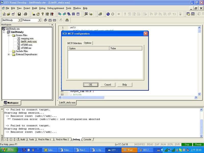

Our company bought 10 set of RLINK for half year. We had 4 set of RLINK are damaged, Do you have similar experience?
There are 2 type of response.
1) STVD7 cannot connect RLINK (may be power section problem, can i have the schematics to trace?)
2) Connected with STVD7, but promoted that, not right MCU selected, and the option table is blank, nothing to choice. (???)

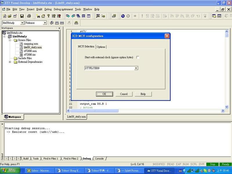

For my RLINK, it is being used well on Indartkit-LITE0 EVboard for such long time. My lastest RLINK had just already damaged before my last mail. For my own set, I think it is not RLINK problem, it should be my fault, because once i changed to the board ST7FOPTION-EVAL, the window(PC) was hanged (blue screen), after i reset and re-connect RLINK to IndartkitLITE0-EVAL & PC, the right bottom shown the USB devices cannot be recognized .....
I checked the other 3 set. here are the response after RLINK connected to PC
My Set & the Set 1 - USB devices cannot be recognized (descripted above)
Set 2 & 3 - After STVD7 start debug, RLINK LED ''power'' and ''busy'' are remain ON. And then STVD7 prompted a box. Picture attached below

According to ST, the ST7FOPTION board is obsolete, and they don't have any left in stock. Therefore, I'll not be able to try it myself.
However, I could look at its schematic and saw a potential problem for the RLink: there is no jumper to disconnect the OSC1 from the RLink to the target cpu (there are jumpers on the Softec boards), and there might be an electrical conflict if W4 ties it to GND or to the board's oscillator.
Please tell me what the jumper settings for W4 and W5 are, on your board?
Also, maybe you can try this test to check that the RLink clock is still running:
1. Unconnect the ICC cable and the RLink's USB.
2. Connect the RLink's USB.
3. Connect a power supply (between 3.3V and 5V) to GND (pin 3) and VCC (pin 7) of the RLink's ICC connector.
4. With an oscilloscope, check that OSC1 (pin 9) is oscillating at 12MHz between 0V and the VCC you supplied.
Finally, did you connect anything on TP1? It contains PA0 and PA1, which are the ICC pins and should be reserved for programming and debugging. If you connected anything to it, then that might be the source of the problem.
If all this doesn't help, then I'm afraid I'll have to ask you to send your RLink to me for inspection.
Note: the RLink's Serial Number can be read using RIDE or RFlasher, but it requires the USB enumeration to succeed... :(
