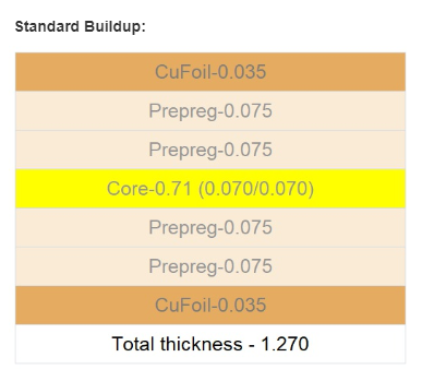

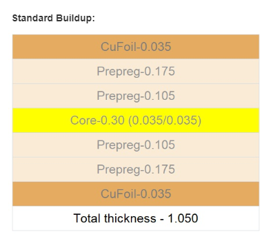

My team and I have been working on the design of a radio module using the STM32WLx5 MCU. To simplify the RF front end, we decided to go with the BALFHB-WL-02D3.

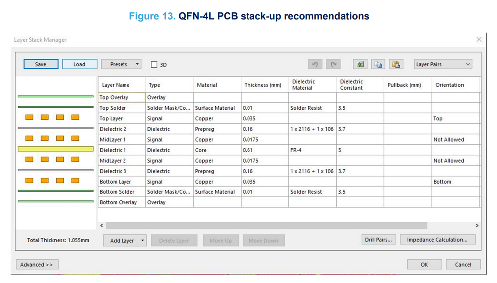

In the BALFHB-WL-02D3 Datasheet, the below mentioned board stack-up is recommended for the best RF performance. This stack-up comes up to a 1.085mm board thickness (which is non-standard)
We had a few questions on the stack-up:
Thanks,
MoralkaraLynn
2025-02-20 11:56 PM
Hello Moralkara,
With BALFHB-WL-02D3, Total thickness is not important effect on the performance. The important parameter to respect in the stack up is the thickness of the dielectric2 (it is necessary to be close 0.160mm) between top layer and first ground inner layer.
The second stack may be suitable because the two prepregs are approximately 0.150mm
On your stack up, we don’t see inner layers. Do you have inner layers?
It is important to respect the layout of the datasheet and to have a ground plane under the BALFHB-WL-02D3 on the first inner layer with dielectric2 around 0.160mm.
