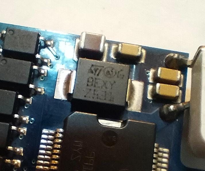

Hi all
I have difficulty to find data sheet of this part  BEXY Z531  st BEXY Z531.jpeg
 thank you for any respond
Best Regard
Peter BENSCH
Welcome @AGGA44, to the community!
the marking BEXY stands for the SM15T39CAY, a 1500W TVS.

Thank you Mr Peter BENSCH for the information
