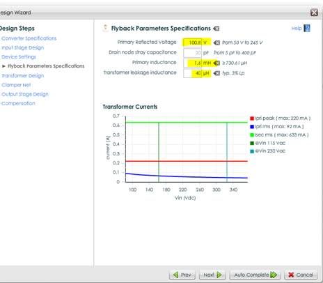

my name is pini i work on new project AC/DC converter
the input is 85-265 VAC
output  12vdc/350mA
axiliry :16vdc
chip:viper013HS
I work with a midcom transformer 750370024 and viper013hs
I don't how to set this transformer in simulate (how to enter the parameters)
this is EE13/7/4 but
I do not have all the
parameters of the transformer
How can i run the simulation correctly?
thanks

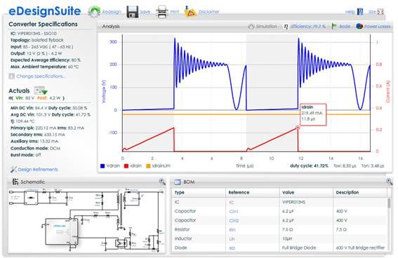

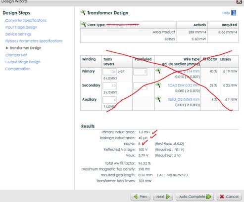

For your simulation in eDS you need the following parameters for the transformer:
From datasheet:
Main inductance: 1.6mH
Leakage inductance: ~40uH
Turns ratio Pri:Sec = 8:1 => reflected voltage = 8*12.6V=100.8V assuming a 0.6V drop voltage on the output diode.
Here are the steps though eDS that I went through:
As you can see, for the simulation purposes, the transformer internal construction is not really needed as long as the transformer parameters are given along with the condition that peak current to be lower that the transformer saturation current:
