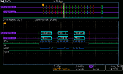

Here is address 0x04, which fails to write:

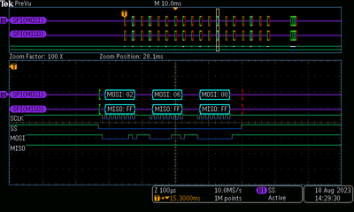

Here is address 0x06, which also fails to write;

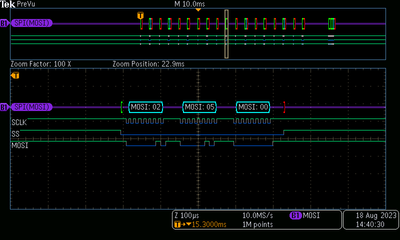

Here is address 0x05 which writes just fine.
Here is the full event table:
TimeMOSI
1.000000e-0706
2.349700e-0302 00 1F
5.059400e-0306
7.409000e-0302 01 FF
1.011500e-0206
1.246470e-0202 02 FF
1.529390e-0206
1.763990e-0202 04 51
2.033090e-0206
2.267690e-0202 05 00
2.536780e-0206
2.782890e-0202 06 00
3.051620e-0206
3.286220e-0202 07 32
3.561050e-0206
3.796010e-0202 08 FF
4.076830e-0206
4.311420e-0202 03 26

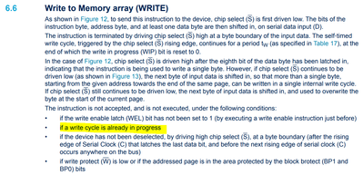

Your write signals look fine. Show the corresponding read function immediately following a write and/or corresponding code.
Note that a write will fail if one is already in progress. Given your every-other failure scheme, I bet this is what is occurring. I don't see any checking for the WIP bit.
