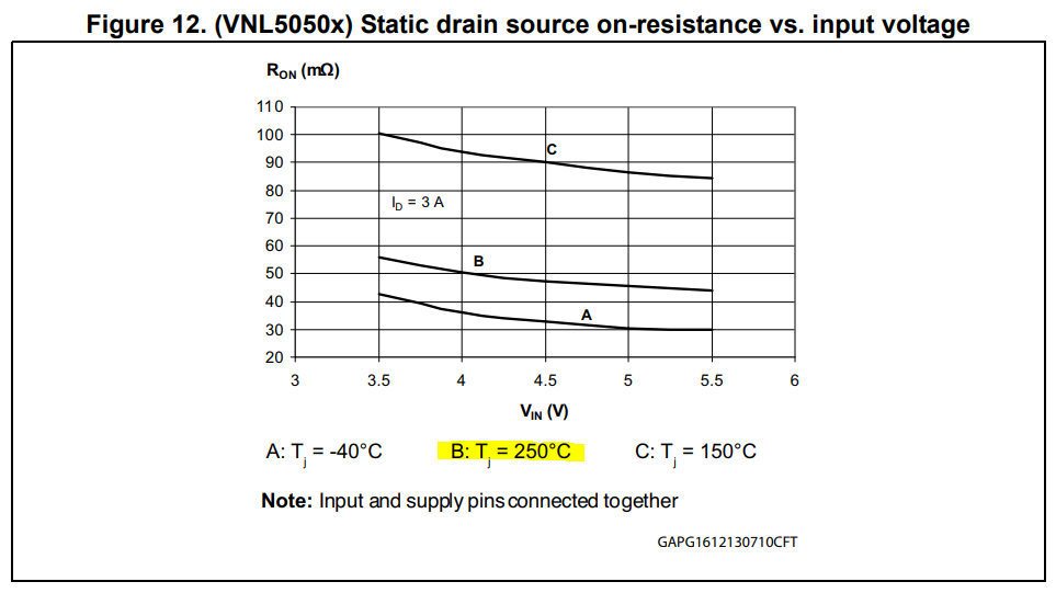

Hi ST TEAM!
I was reading through the low side switch app note
http://www.st.com/content/ccc/resource/technical/document/application_note/group0/12/27/2b/c6/ba/ca/4c/16/DM00255001/files/DM00255001.pdf/jcr:content/translations/en.DM00255001.pdf
I don't believe this device actually goes to 250C, but if I'm wrong let me know because that is amazing!!
Regards
-JWL
#vnl5050x #error #an4798
1 REPLY 1
Posted on May 10, 2018 at 13:13
Ciao Jason, you are right...it is a typo! We will immediately ask for the document review, thanks a lot for your contribute.
Feel free to contact to contact me for any further info about the VIPower Low Side Driver family. Regards. Martina
