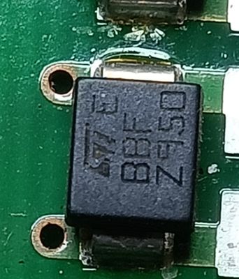

buon giorno a tutti sapreste indicarmi che tipologia di diodo è questo l'unica cosa e che è bidirezionale per il resto non riesco a trovare nessun datascheet

Looks like it's a SMBJ13CA based on the BBF marking. TVS diode.
https://www.st.com/resource/en/datasheet/smbj58ca.pdf

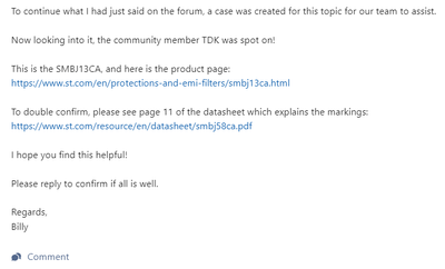

I feel like sometimes my replies are just completely ignored. Clearly that is the diode in question. Same package, same marking in the datasheet. Why does this need flagged for additional investigation? Does it not count because the reply is not in Italian?

Here, I will even show you, in this case I both mentioned you and gave you some credit :)
