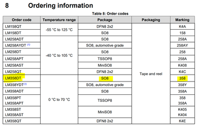

I checked for the IC but I can't identify the number.
somebody knows which is the correct number from the IC in the attachment?

Looks like an LM358 op-amp based on the 358 marking.
Wouldn't be surprised if the issue was elsewhere. Hard to know without any more info.

Hint, If I check the connection from the IC and check the Layout from your suggestion I believe it can't be the correct one because PIN 1/2 are shortcut and PIN 3/4 are shortcut.
Which part could it be?

Shorting pins 1+2 and pins 3+4 is done if that half of the op-amp isn't used. Wide supply traces on pins 4+8 would also suggest it's the right chip. "LM358" is also common, available by several suppliers, and it's unlikely a different chip has that marking. Could always be wrong, but the evidence is strong here.
If it were me, I'd buy a chip and replace it. And if it doesn't fix the problem, I'd check back with Schaudt. Possible that reworking it yourself could void a warranty.
If it happened after the battery was replaced, sounds like a configuration or calibration issue. Just guessing, no experience with this particular device.

2025-01-15 11:22 AM
I had a similar problem and it turned out to be a BSS138 mosfet that was at fault.
