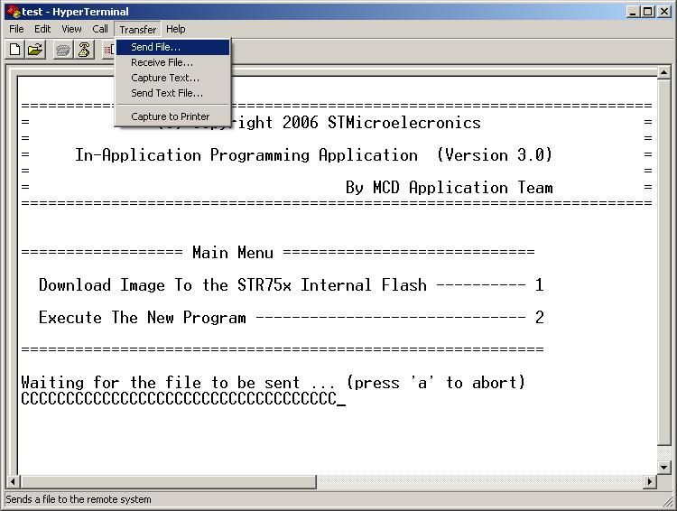

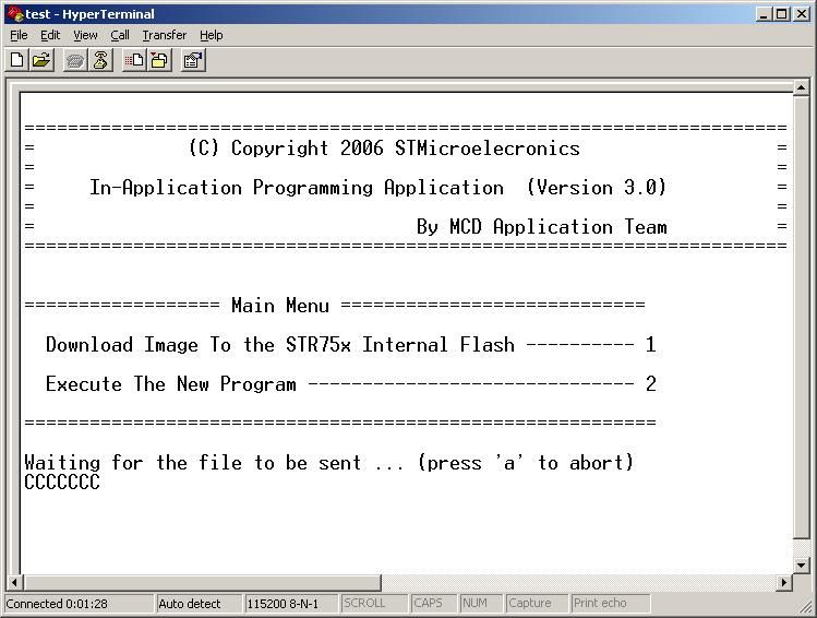

I then connected the REva test board (with STR750 daughtercard) to a computer serial COM port.

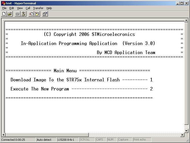

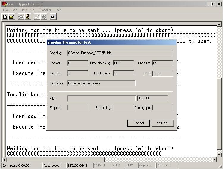

I used both Hyperterminal and Tera Term for testing the serial connection, and both are communicating to UART0 of the STR750, as the following text is displayed on the terminal window whenever the STR750 is powered up or reset (Hyperterminal shown here):
When I press ''1'', I get the following text returned in the Hyperterminal window:
Note: the string of C's are returned to the Hyperterminal window (at a rate of appx. one ''C'' per second) while the IAP program is waiting for a ''send file'' command to be issued by the Hyperterminal program.

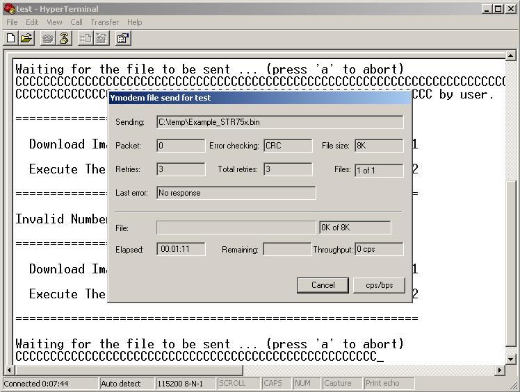

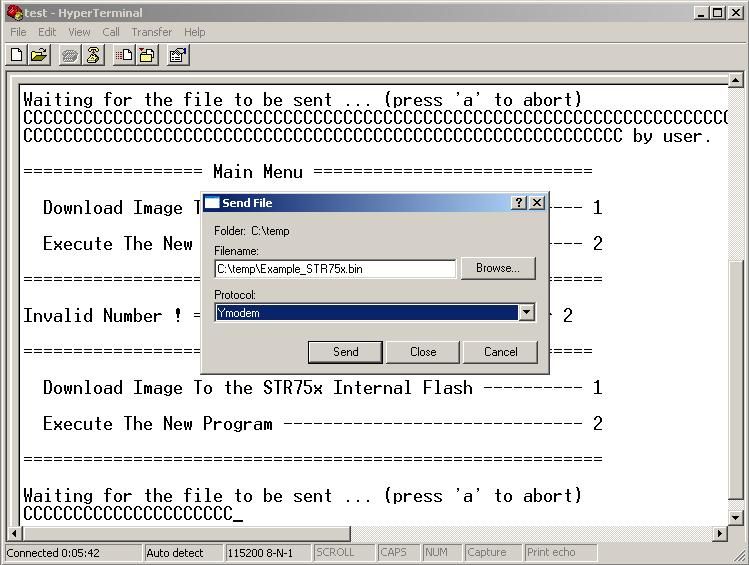

The next two pictures show how I attempt to send the sample binary file (''Example_STR75x.bin''), which was included in the ST Micro IAP project package, using Hyperterminal:
Note that the Ymodem protocol is selected in Hyperterminal, which is what is required for IAP to work according to AN2078.  The file should be sent when the Send button is clicked.

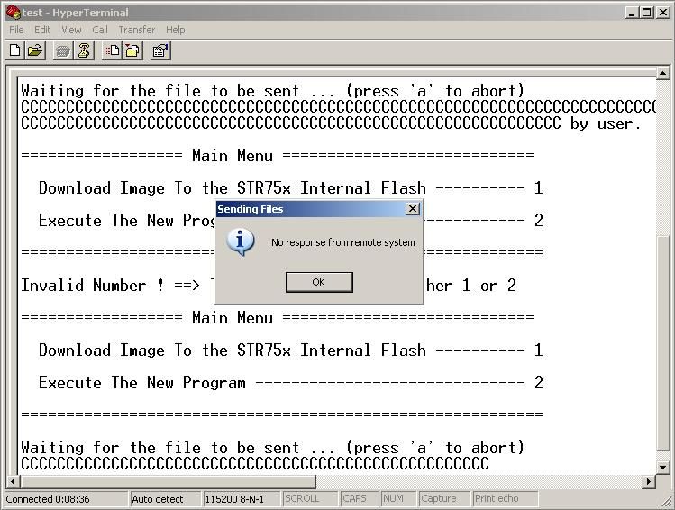

After the Send button is clicked, Hyperterminal displays a progress window, but the file is never sent.  What is seen in that progress window are two things:
1. The initial ''Last error'' field displays ''Unrequested response''.
2. After about a minute, the ''Last error'' field displays ''No response''.
Finally, after two minutes have elapsed, the Send session times out, and Hyperterminal shows the following message:

For the Flash to be mapped at 0 you need two things:
1. The Boot Mode option in Ride should be set to FLASH. That's for the compiler and linker.
2. The Boot pins on the board must be set to FLASH. That's for executing the program without the debugger. (see the board's doc and schematic for details)
To check it, program the board using JTAG then power it OFF and ON and check that it speaks on the UART. (without launching debug in Ride) If it does, this proves that your application is programmed and running in Flash at address 0.
From your report I think that you are doing those things correctly. Because the program speaks.
I'm not expert in those IAP apps, but I would investigate towards other things, like the protocol for sending the bin file.
