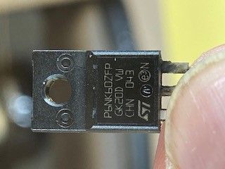

I need to replace this part like for like and need to get a part number/quote if possible?

This STPNNK60ZFP is a really old MOSFET and could be replaced by e.g. STF33N60DM2. It is much more powerful (lower Rdson, higher current, higher avalanche energy), while being comparable in the driving specs (total gate charge).
Please contact your most favorite distributor for a quote.
