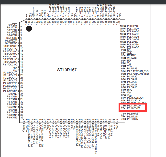

I didn't found ST10R167 JTAG/Programming port. Can any know this please post.

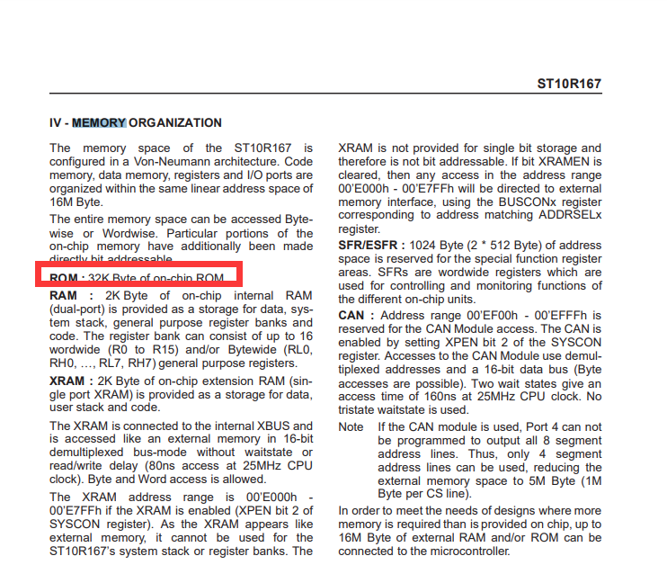

lsun.1
st10r167 has 32kB internal ROM
_legacyfs_online_stmicro_images_0693W00000bjE3RQAU.pngIt can be programed by TXD and RXD, st10 flasher tools
