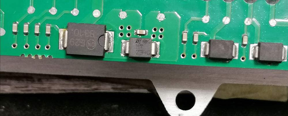

I can't identify this component, it says on it: G MT Z340
MFede.1
SM6T33CA
5 REPLIES 5
Ozone
Principal II
I would guess a schottky diode.
Perhaps the ST equivalent to the B340A.
SM6T33CA
MFede.1
I don't think it is a diode because removing the component from the board and measuring it with the multimeter is in diode or ohm mode I have no result. maybe it could be bidirectional, how did you understand that it could be a SM6T33CA?
Its listed in the data sheet​
ok i saw, thanks a lot for the help
