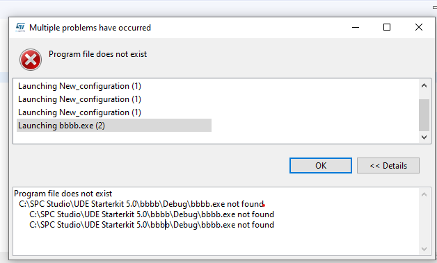

I did everything, it's properly for example C code.
But I am getting error log as shared in below image.
