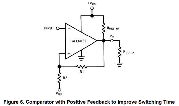

Does LM239 Support Hysteresis?
Can this, or another, hysteresis circuit work with LM239?
LM239 datasheet doesn't mention hysteresis.

Thx, should have occurred to me to look at a different manufacturer's datasheet. I wonder why STM's datasheet doesn't include that.
This search gives additional detail:
https://www.google.com/search?q=%22lm239%22+external+%22hysteresis%22
http://www.ti.com/lit/an/snoa654a/snoa654a.pdf
see section 4 Comparators with Hysteresis

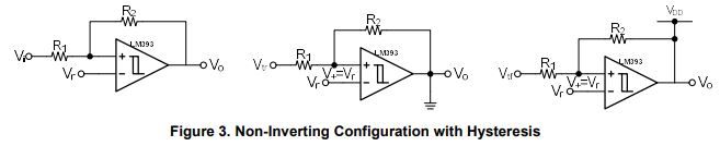

3peak:

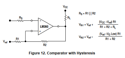

0693W0000000AWjQAM.jpgTI:
I'm wondering if the circuit would be different for a single supply. In my application, i'm making an over 0V detector, with a switchpoint of about 50 mV on the upward swing. Therefor, my ref would be connected to Ground.
Your 3peak sheet shows no ref R, but the other sources do show a ref R. What's the function of the ref R? What's drawback of not using it? Is it needed with the LM239 and a single-supply?
Same question re input R. The TI sheet one, but the other sources don't.
Same question re pullup R on the output.
thx
