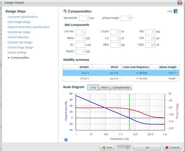

Can i change opto CTR in STCH02 design'
TVecc
Hy,
can i change opto CTR and so on?
0690X00000AQyFIQA1.jpgregards Tiziano
Patrizia BELLITTO
you can change the CTR min value visible as first field in the Net components form.
Best regards,
Patrizia Bellitto

Patrizia BELLITTO
Best regards,
