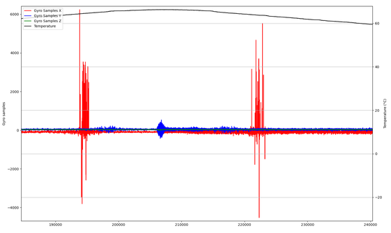

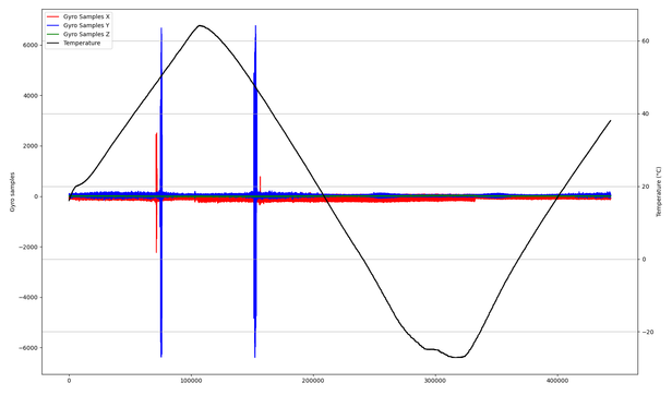

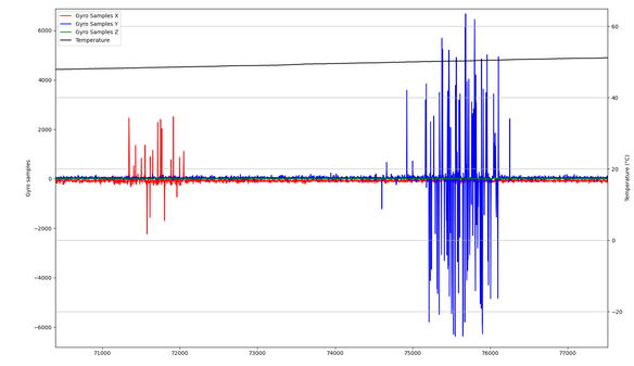

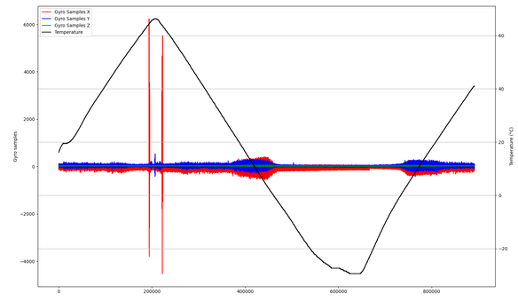

I work for a company that has used this IMU for some of the new designs (we have currently assembled and tested +1000 units with ASM330LHH) and we have noticed that some of the units (around 10 %), are presenting a strange behaviour when subjecting them to temperature cycles, the effect has only been noticed in X and Y axes, never in Z. Here is a plot of the behaviour:
The x-axis of the graphs represent the incremental samples, and the y-axis in the left-hand side represents the raw decimal number read in the 16-bit registers. The y-axis in the right-hand side is the temperature in ºC.
The unit is completely static in a controlled environment, a temperature chamber. There is evidence that there has not been any physical motion during the peaks, due to the information provided by additional accelerometers in the same PCB. The ASM330LHH accelerometers do not show this behaviour.
As it can be seen, the unit presents wrong measurements at similar temperatures. In all the tests where this has happened, the effect is seen at approximately similar temperature (+-10 deg) in one unit. When changing the unit, this effect can be repeated at other temperature. The effect does not always happen with the same unit, the effect is not perfectly repeateable.
