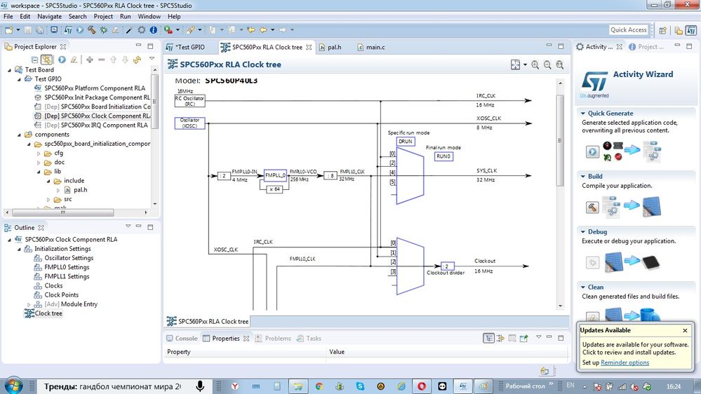

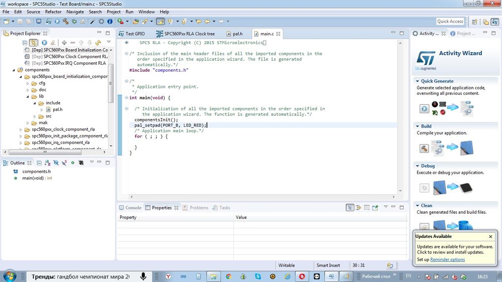

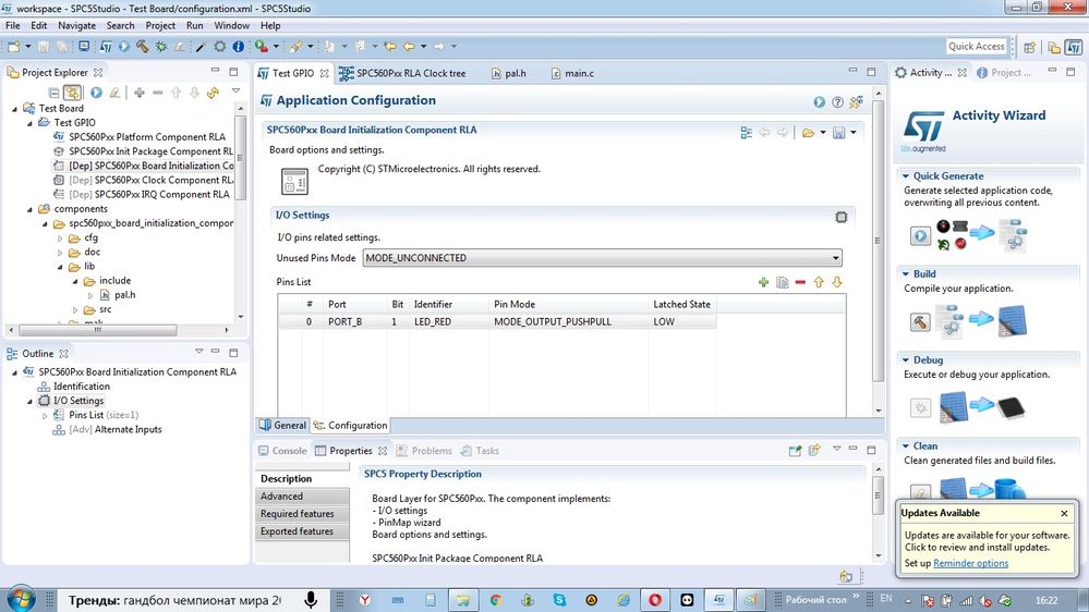

Good day. This my first application on spc5 studio. I add for testing one led on Port B[1] to board witch MCU SPC560P40L3. I add in generate main.c file one sting -pal_setpad(PORT_B, LED_RED);. Pin will add pin-list, and adjust Clock timing for osc=8000000 Hz.
Afte download outfile out.hex to MCU and start application-pin not state low or hich. Pin state Z(hich impedance).

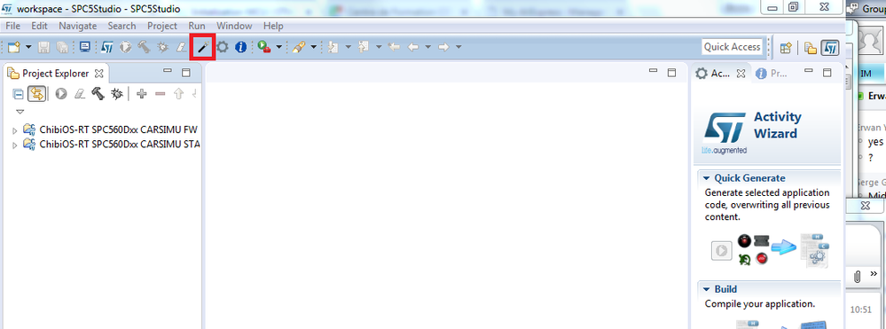

i think that your clock configuration is not correct.
Do you use SPC560Pxx Discovery Board or SPC56Pxx Motherboard and Minimodule
There is some Test Applications examples for these 2 Hw (RLA & HAL) in the application wizard.
You can import them by using the magic stick cf screenshot
   Best Regards
        Erwan

Thanks. Solved. Select HAL confuguration, selekt not init, manualy configurating clocking module, editing hal_lld.c
