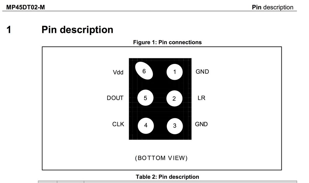

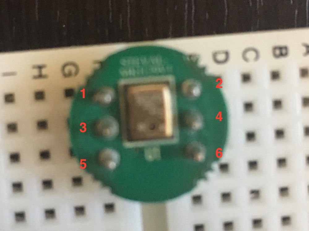

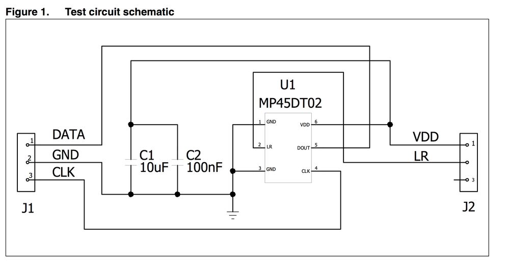

I am trying to use the
http://www.st.com/en/evaluation-tools/steval-mki129v1.html
board on a breadboard. It has ahttp://www.st.com/en/audio-ics/mp45dt02-m.html
. I am trying to resolve the two data sheets to determine the mapping to the coupon pins. Can anybody tell me the pin mappings for the coupon board with pins ordered from the top as in the attached photo?I also attached the relevant diagram from the two data sheets.
Thanks in advance for any help you can provide.
