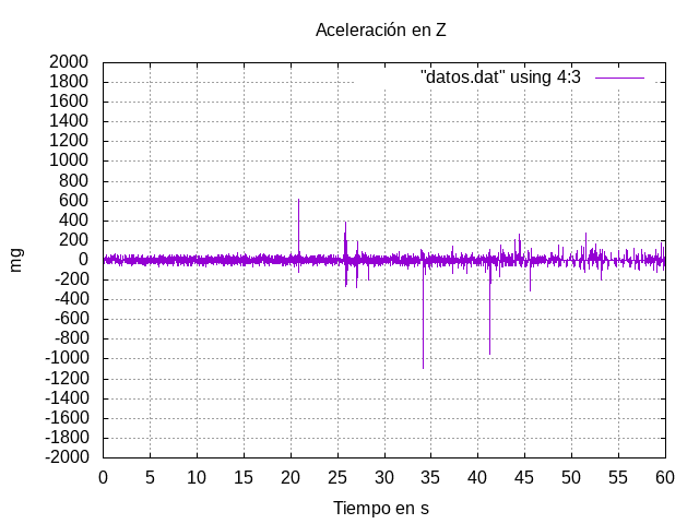

Hi, I'm testing with the LIS3DHTR and I notice that the Z axis is noisier than the others axis. It doesn't matter the position of the accelerometer, always the Z axis is noisier. Why does happen?

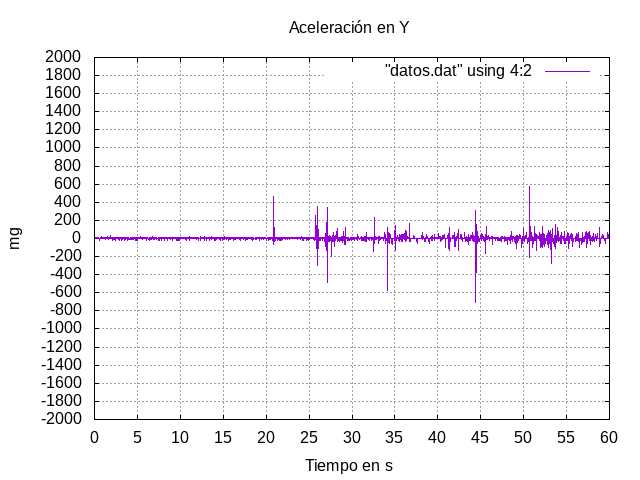

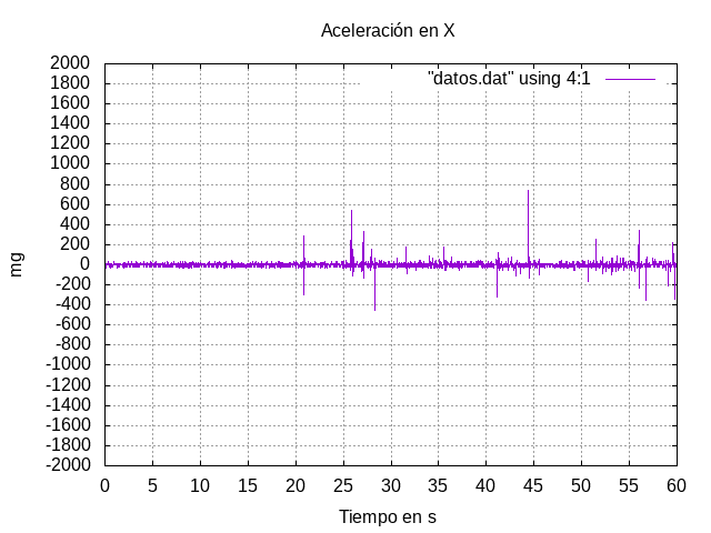

Yes, I know. I'm already separating the DC component from the offset but I still see a lot of noise. I share some small examples of the measurements that I have.
As you can see, the noise on the Z axis is very high. In the other axes the noise is also high, but acceptable. I am using a full scale of 2g, with an ODR of 100 Hz. I really don't know why only the Z axis is so noisy.

I see, thank you for sharing the data... you said that you are seeing the issue also when the device is in a vertical position, i.e. with the z axis not orthogonal to the ground, right?
Can you try lowering the ODR and checking the noise?
And did you have the possibility to test another LIS3DHTR?
By the way, to check if the device is good (maybe has been damaged in the past for some handling reason), you can run the self test procedure: it is described in the AN3308 application note p.57, and the C code for the application is on Github (lis3dh_self_test.c).

Hi @Eleon BORLINI​ ,
I have 3 LIS3DHTR more, I test all of them and I see the same results. In all of them the Z axis is noisier than the others. If I decrease the ODR I can see how the noise is lower but in the z axis is still very high. I use the 2G full scale and the High Resolution mode.
The results of the selftest are te same, a lower noise but still high. Could it be due to soldering process?
