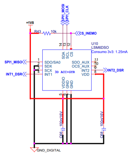

Currently, the free fall detection (a bit different from a man-down application, but "yes" to question 2) is implemented at firmware level, not exploiting the embedded feature of the LSM6DSOX.
>> How to calculate or get fall detection?
In this video, it is described how to implement the free fall detection via the STBLE sensor smartphone application.
You can just set the threshold above which the free-fall is defined (in the example, 200 milli-g) and you'll receive a notification every times this threshold is crossed.
If you want to implement the free-fall at firmware level, you can start from the FP-SNS-STBOX1 examples.
If otherwise you want to exploit the embedded feature of the LSM6DSOX for the free fall detection as explained in the app note AN5272, p.42, you can exploit the INT1_DSR and INT2_DSR pins from the schematic:

Eleon BORLINI
Hi Ravi @RShiv.1​ ,
If you want to use the Sensortile.box as a free fall detection tool using the the LSM6DSOX, I suggest you to start from an existing FW, configure the LSM6DSOX for the free fall detection and then enable a LED (for example the green one).
You can do it as described in the previously linked video.
You don't need to run the MLC, in principle.
However, if you are interested in a more complex pattern recognition (such as a particular man-down), you might need to set up a more complex configuration.
In this case, on the BLEMLC section (p.17 of the user manual UM2626), and from slide 280 of this presentation you can find more information for a starting point.

Eleon BORLINI
Hi --Ravi @RShiv.1​ ,
unfortunately there is no demo application available for the man-down event detection, mostly because it should work 100% of the times, since it is a medical application, with related responsibilities.
You could however make some basic tests exploiting the free fall, and then improve your tests by training a proper MLC. You might for example use the 6D position recognition, that should be able to distinguish between stand position and flat position. But you should carry out some test to test whether it can be reliable enough for your purpose.
There is also a broader literature on the topic, that you can find online and that could drive you to a better implementation of the algorithm.
